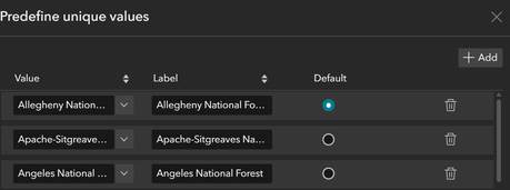

I’m running into an issue with a Group Filter in Experience Builder that uses multiple data sources, all of which share a common field of National Forest Name. The filter uses the contains operator with predefined unique values. I’m using contains because some data sources store multiple forest names in a list. I set a single default value (Allegheny National Forest) and intentionally removed the “All” option so only one forest loads by default. The filter is also set to “Apply this filter automatically.”

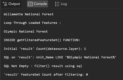

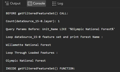

If I select any forest other than the default, the Arcade expression fails with this error:
Test execution error: Execution error - Cannot access property of null object. Verify test data.
When I inspect the data source using Console() messages, it appears that the FeatureSet only contains one feature—always the default forest value—even though the queryParams.where correctly reflects the forest I selected in the filter. The loaded features do show the correct forest name, but the FeatureSet being passed into Arcade still contains only the default-value feature.
If I change the default predefined value to a different forest, the same behavior occurs: the data source always resolves to the default value, even when the filter selection changes.
mdesh23_0-1782242518255.pngmdesh23_0-1782242518255.pngmdesh23_1-1782242527773.pngmdesh23_1-1782242527773.png
Is this a bug related to using a default predefined value in the Group Filter, particularly in how it influences the FeatureSet returned by getFilteredFeatureSet()? Or is there a configuration detail I may have overlooked?
