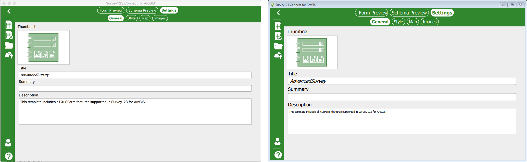

Has anyone else noticed that applications built using AppStudio tend to look significantly better on Mac than they do on Windows? Windows apps built using AppStudio, imho, seem to have an issue with antialiasing or scaling of digital assets. I'm not sure what it is but there is a noticeable difference. I've also noticed that Windows Apps seem to be more buggy.
Take Survey123Connect for example. On the Mac (left), the everything is clean and crisp, text is centered inside the buttons, it looks great. On Windows however, there are some noticeable issues with centering text inside the buttons and the lines GUI elements aren't quite as smooth or clean as they are on a Mac.
Why is this and is there anything I can do to fix it on Windows-versions of my apps? Am I just crazy?

Regarding the 'crispness' this is very much dependent on Windows hardware and display resolutions. On my Surface Pro 2, Connect (and other AppStudio apps) is super sharp.
Specifically regarding the centering of some text - this has been fixed in the pending 1.7 release.

Thanks for the response Marika, that makes sense.
I've noticed in Esri's sample applications and also in Survey123, Esri tends to use use PNG files and also uses some PSDs. Is there a reason for this? Also, is it possible to use SVGs and eliminate the issue altogether? This seems like a kind of odd issue to have for an SDK and framework that are intended to be cross-platform and executable on just about any device. I mean, if I compile the application for iOS, Android, Windows, Mac and Linux - the display resolution and hardware options are literally endless.
Are there any tips for getting the best UI results that are hardware and platform agnostic?

Yep, we have psudeo standardized on png's partly because of our ArcGIS Online integration. Thumbnails in ArcGIS Online are png's hence so are ours. The psd's included in samples are really treated as source files for editing images - and are not directly referenced in the apps.
When it comes to images inside your own app - yes you could use SVG's, its up to you.
