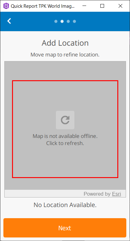

We are using AppStudio for ArcGIS Desktop version 4.2.80.
We were looking forward to add custom functionality to download basemap as tpk on fly.
We added services from tiledbasemaps.arcgis.com as basemap in our public webmap. However, the webmap does not load in the quick report application when launch it.
It is important for us to make this work with services from tiledbasemaps.arcgis.com since these services are enabled with export tiles enabled and that would be used with ExportTileCacheTask
We were able to run the sample with basemap: World_Street_Map (MapServer)
Is there any configuration in AppStudio for accessing services from tiledbasemaps.arcgis.com as basemap?
Or is this an expected behavior?
