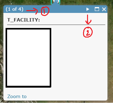

For example we have multiple point features belonging to different feature layers in the sample below:
We would like to have all the intersected layers info with respected to point clicked in one popup window like following:
The screen shot above is from webmap but it is a good sample to show how we would like to toggle through all the features with help of 1 and 2 in the image above

Brent,
We have IdentifyLayers, GeoView QML Type | ArcGIS for Developers that would identify in all of the map layers.
You can try this in our MapViewer template, the MapViewer template would identify the features from all the layers in the webmap.

BrentSlone3
Thanks for the help Erwin, we were able to solve the issue thourgh MapViewer template
