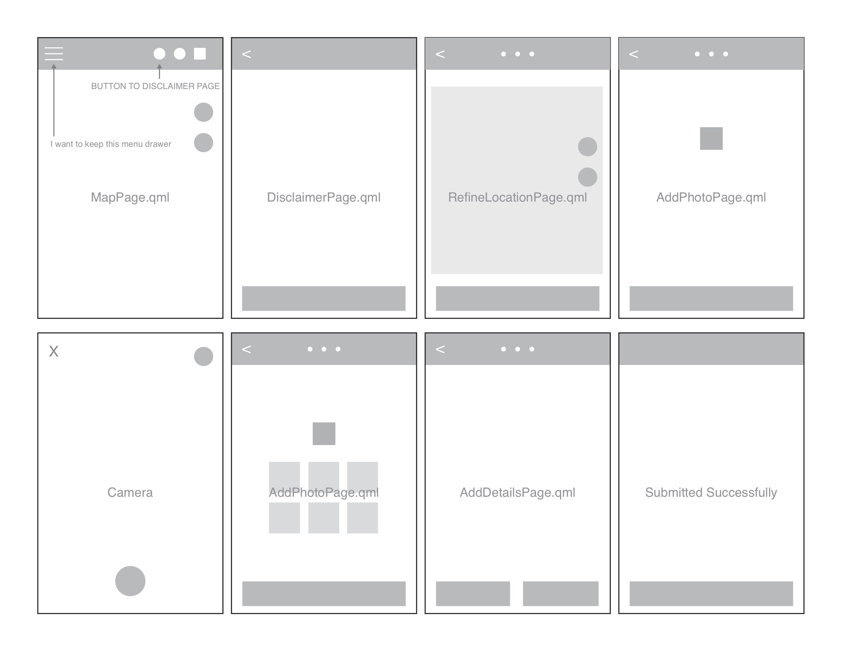

For the final app, I want the MapPage from the MapViewer template to be the landing page. I am going to add a button on the header to to get to the DisclaimerPage. See the attached sketch for the a visual representation of how I envision the app working.
What I am looking for is the most efficient way to combine these two templates without breaking the functionality and infrastructure that are inherent in both. Should I copy all the files from the MapViewer template to the QuickReport template in Finder? I am working on a Mac.

 App wireframe

Garrett,
Copying the entire content of the file from one template to another would not work. But taking the time to understand how each of them work then copy just the portion of UI code and portion of the Javascript code from one to another is the way to go.
So it's good that you already have some kind of vision of how it's going to look like. Not everything should come from MapViewer, they can also come from our sample as well.

Would you suggest that I right-click and Add New... (I am on a Mac) to create a new MapPage in the QuickReports pages and then try to copy the associated UI code and such to this page?
What about the other .qml code that is set up in the controls and views folders that are used by the MapViewer MapPage? For example the MapPage references the Icon.qml and other .qml files in the controls folder and the Panel.qml and other .qml files in the views folder. Should I right-click and Add New... to copy the code and create these files in the proper location within the QuickReport folder structure?
I guess this is what I originally meant by copying and pasting the MapViewer template files over to the QuickReports template. However, I think that the MapPage.qml file also references the MapViewerApp.qml file.

Garrett,
Oh yes, I think the code that is in the "control" folder or similar to it, can be copied and pasted from one to another template since they are very compartmentalized. Let's say you copying portion of the UI from MapViewer page, and that UI uses the "library" from the control folder, and yes you can copy it. I often do this myself too.
I am glad you are progressing along, putting one foot in front of another.
