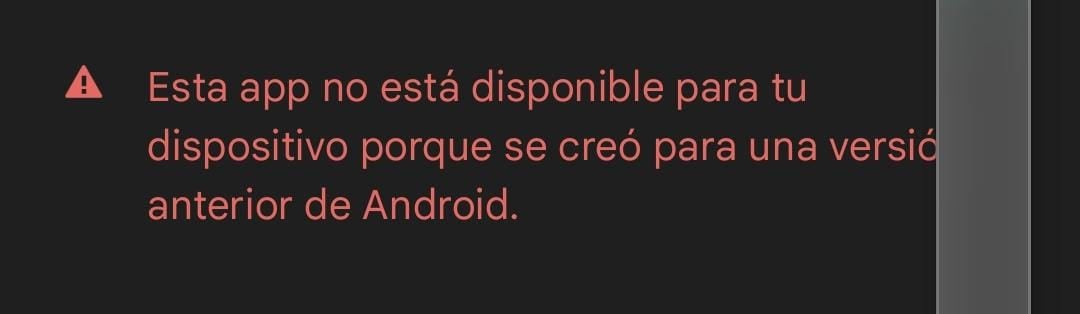

It works fine but when i make the apk and upload it into Google Play to internal testing it shows the following message as a tester:
Translated: This app is not available for your device because it was built for an older version of Android
Note: I'm trying to test it in Android 11.

Hi @Leandro-Zamudio ,
This issue may also happen because of an outdated AppStudio app (5.4), I recommend you download the latest version 5.5.180, and re-do the Cloud Make process because the Cloud Make systems are really setup to only support latest AppStudio versions and any previous version may not cloud make correctly as expected. Let us know if that works.
If the above process still shows the error, we would like to know the exact steps you were performing to get the app? Also, when was the initial apk downloaded? Any kinds of changes or updates you made after that to the app?
Thanks.

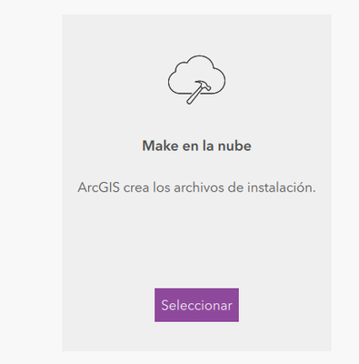

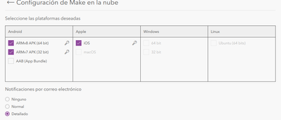

In app studio I just:
1. Set up the settings (certificates and stuff) the update i did in the apk was change a featureservice parameter (nothing changed in the code). Just in case i deleted the minimumsdkversion and targetsdkversion for android
2. Upload it
3. Select Make and choose cloud option.
4. Set the password for android and iOS keys.
5. and request build, download from OTA and upload it into play console
