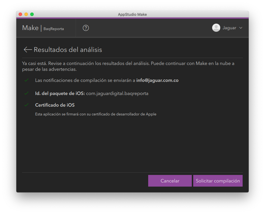

Hi
I used the Cloud Make to compile an iOS app based on QuickReport template, it doesn't show any error, neither on the analysis nor in the process
I accessed the .ipa installer through http://appstudio-ota.arcgis.com directly from Safari on an iPhone
After installation, the icon never appears and the App simply doesn't start
I already published an APK for Android that runs without any hassle. What could be wrong with the .ipa?
Any help will be appreciated

Hi Erwin, thanks for your answer. With further tests we found which platforms run the app properly:
- Apple iPAD 10.2 - iOS 13.5.1, Worked
- Apple iPhone X - iOS 13.5.1 Worked.
- Apple iPhone X - iOS 14.0 Worked.
- Apple iPhone 7 - iOS 12.4 Worked.
- Apple iPhone 6S - iOS 10.3.2 It didn't work
So it must be the target platform, but the only configuration setting seems to be the Cloud Make URL address. Is there anyway to set the target platform through Cloud Make?
 Thanks in advance,
Oscar
