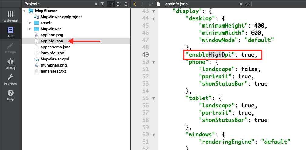

Matt,
You can do that by changing a property in appinfo.json called "enableHighDpi" to true.
Thank you,
Erwin

Matt,
Thank you,
Erwin
