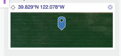

I use the Survey123 code sample from appstudio (3.11) and extend it to build my own app.  I recently upgraded to this version from an older Survey123 sample.  It all works fine except my GeoPoint/Poly capture on a survey only seems to show street basemap only?  And when I try to change the basemap the popup for selecting a basemap is empty?  I used the cloud build to make this application and on android/appStudio the capture works correctly and defaults to imagery and allows for "Select a basemap" popup to be populated.  Not sure how to fix this because I can't debug in AppStudio as AppStudio mobile work on Iphone, but sideloaded ipa is the only way to reproduce this issue.  Here are the screen shots of the geopoint capture on iphone sideloaded .ipa file.
Geopoint preview is street map (it should be satellite like it is on android)
When I go into the capture it is street
When I open the Map popup selector it is empty?  This is only on IOS sideloaded
