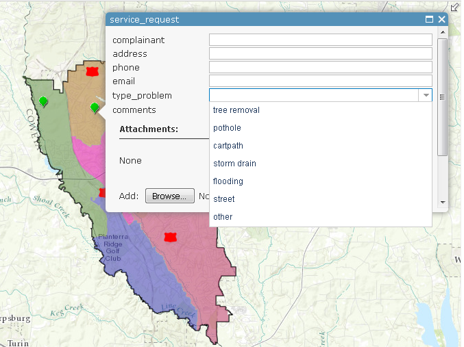

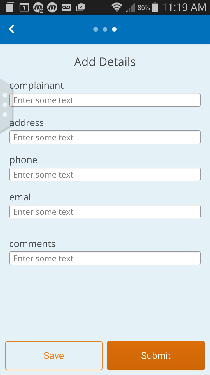

Hey community, I have a feature service that is not showing one attribute - which happens to be an important attribute; My 'type' field, which has a domain to allow selecting from a drop down menu, is the only attribute field not showing up in my test App of QuickReports. When I look at my data I obtained using my unpublished App, I see all the data is there to include photos and the field 'type' is viewable via ArcGIS Online. When I use ArcGIS Online to update this feature, my type field is available with said drop down menu. I've attached a few photos which I hope illustrate my issue. Feature in ArcGIS OnlineFeature in Phone App

Hi Anthony,
To fix the issue, please go to QuickReport\pages\AttributesPage.qml, near the line 148, change the highlighted code
to
domainTypeIndex = getTypeIndex(modelData["domain"]["type"]);
After that, it should look like:
Hope this will help!
by Anonymous User
Not applicable
I appreciate your assistance but I'm having no luck. I've changed that page via the AppStudio for ArcGIS web version then through the Qt link
But it seems what gets loaded to my phone is an unsaved version of that page?? I say that because after I scan and load and see my field not there I'll relook at it again in Appstudio and not see my changes?
Is this a licensing issue? I only have Basic for testing purposes.
LiweiGao
Deactivated User
The highlighted line should be "domainTypeIndex = getTypeIndex(modelData["domain"]["type"]);"
Please change it and try again!
by Anonymous User
Not applicable
Thanks all; fixed
