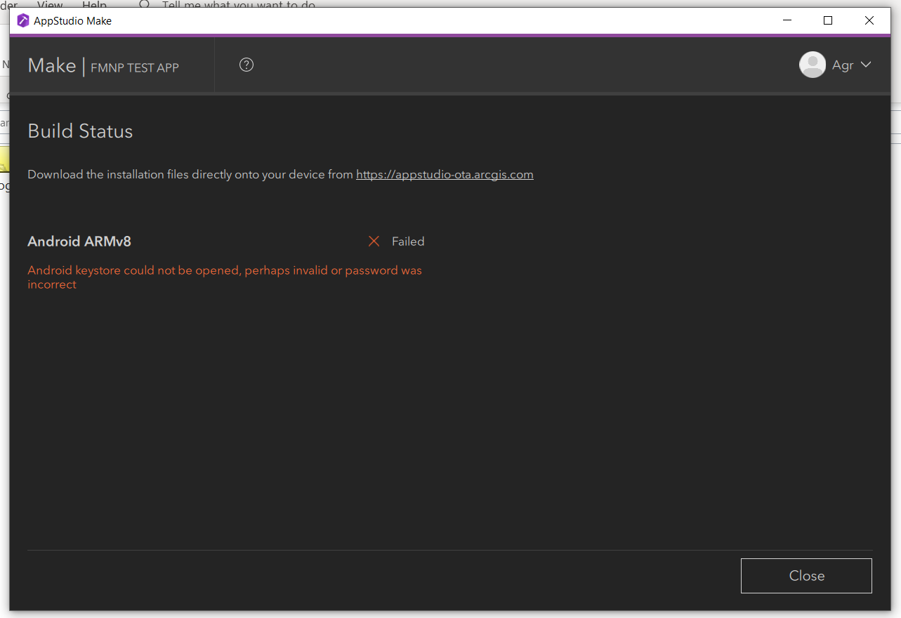

Now, when I do cloud make we have to enter KeyStore and upload key passwords, here I enter the same password for both KeyStore and Upload key, which I have entered for my KeyStore file while generating it using the keytool. When I start the make processs, it gives me the below error
Any help on this is much appreciated.

It looks like there is an issue with the password, can you try changing the password to not use special characters?
Erwin.

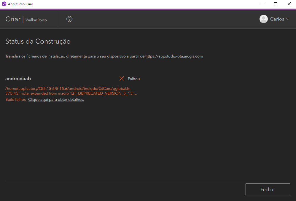

I get the following error "jarsigner: key associated not a private key" when I try to build a maptour app on appstudio using cloud make.
I have been using this keystore in the past and always worked until now.
Any ideas about this issue?
Thanks
