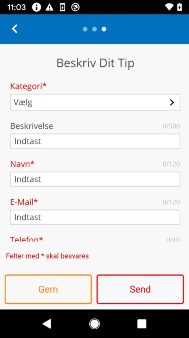

I have created  a Quickreport app using AppStudio for ArcGIS 3.x which had been published succesfully to both Google Play and Apple Appstore. Because i had to update a URL in the app, i needed a new version of the app. I built the app using AppStudio for Desktop 4.0 Cloud Make (ARMv7, ARMv8 and iOS). The iOS and ARMv7 works as intended, but the ARMv8 version messes up the dropdown where the user choose the issue they want to report.
The following happens:

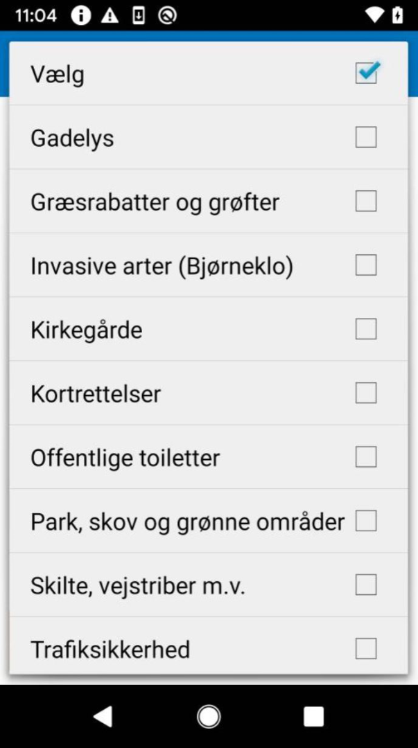

When clicking the dropdown box the domains are shown:

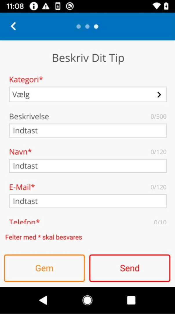

When any of the options is chosen the dropdown closes and the selection does not update:
Now it's not possible to open the dropdown again.
This is only happening on the ARM64. As Google requires an ARM64 version of the app, i am not able to update my app.
How can i fix this, so i can get my app updated?
