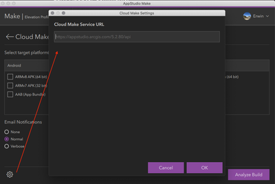

- Make sure to remove the URL in the Cloud Make page settings, this is to make sure you are hitting the right default URL that includes the fix.
