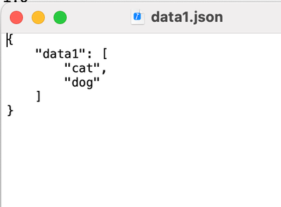

@JamesGough ,
You are correct that arrays can be used in JSON at the top level. This would be considered a JSONArray. However, the FileFolder functions writeJsonFile or readJson handle JSONObjects which expect {} at top level. You can use your code snippet above and change line 33 to this and it will work.
var okWrite = folder.writeJsonFile("data1.json", {data1});

JamesGough
Thanks for the response, I guess I never considered a JSONArray to be a distinct format from a JSONObject. In javascript or python the JSON encoder functions will take either arrays or objects when writing JSON. Maybe that is different in more strictly typed languages though.
It's easy to wrap an array within an object when passing to writeJsonFile but it seems somewhat redundant to have to add that extra key when all your really care about is the array. Another option is to just use writeTextFile and readTextFile along with JSON.stringify and JSON.parse
