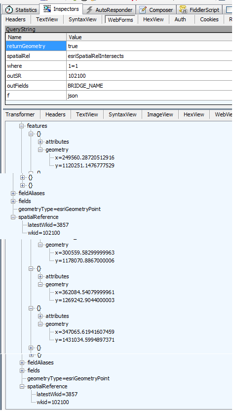

OK. Now the outSR parameter is set, unfortunately it doesn't seem to solve your issue.
Could you show us how the geometry of the returned features look like (as in Jennifer's screenshot)?

I have posted the screenshot of geometry of the returned features.

Humm, the issue doesn't seem to be at client side. The display is consistent with the returned geometry (x, y around 1000000 mean around Nigeria).
Maybe an issue at server side or an issue due to how you published the service.
