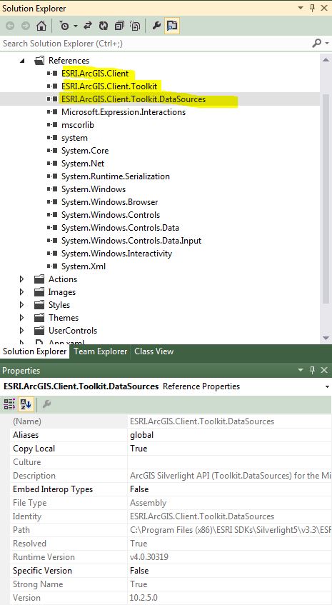

- For the unhandled error from Visual Studio, one thing for sure is when add WSMLayer this Class, you definitely need to make sure all ESRI dll comes from the same version. Since WmsLayer Class from ESRI.ArcGIS.Client.Toolkit.DataSources, therefore you need to import both “ESRI.ArcGIS.Client” and “ESRI.ArcGIS.Client .Toolkit.DataSources” references are the same version. The path for the dll should under this path, “…\Program Files (x86)\ESRI SDKs\Silverlight5\v3.2”
Here is a screenshot for the references:Capture.JPG
