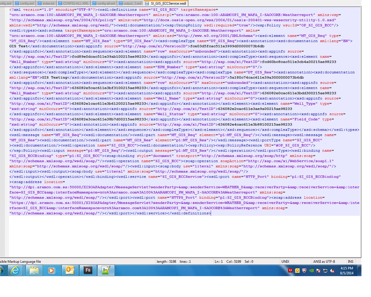

I am looking for a way to use WSDL ( SOAP Service) in my ArcGIS Flex application using Flash Builder deveopment. I am trying to show the data from the WSDL in the SEARCH Widget. I dont know how to add and where to add, i know there is a way to add soap connection in the flash builder for ARCGIS FLEX API, but dont know where to add and how to make it work.

Thanks a lot for the code. I really apprecaite it. I have couple of questions regarding. As I am not a developer and I only know how to use the FLEX API on XML level, I need to understand certain things,.
1. Shall I add this search_result function in SearchWidget.mxml ?
2. What if I have the wsdl file (shown in my previous thread picture) instead of URL and it has to be triggered everytime when I Search a feature using the search widget, shall I give the path to wsdl file in webservice.wsdl="your wsdl URL".?
3. How does the funtion recognize the data structure in the WSDL file.?

  3. You have to have a good understanding of the web services operations (callable function) (i.e SI_GIS_ECC in your webservice) and you call that operation from your webService.SI_GIS_ECC(your input parameters if any);
I can make out much from your screenshot as the xml is not formatted. But you or who ever created the web service would know what the inputs and outputs would be.
