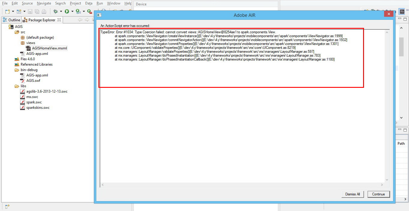

Hello all,
I am new to flex, and Flash builder, I followed the tutorial in this link: https://developers.arcgis.com/flex/guide/tutorial-query-your-data.htm to write a mobile mapping application that includes a query task, after writing the code, no errors appeared in the problems tab but there was 6 warnings, and when running the app the following error appears (Also shown in screenshots):
An ActionScript error has occurred:
TypeError: Error #1034: Type Coercion failed: cannot convert views::AGISHomeView@6396ae1 to spark.components.View.
            at spark.components::ViewNavigator/createViewInstance()
            at spark.components::ViewNavigator/commitNavigatorAction()
            at spark.components::ViewNavigator/commitProperties()
            at mx.core::UIComponent/validateProperties()
            at mx.managers::LayoutManager/validateProperties()
            at mx.managers::LayoutManager/doPhasedInstantiation()
            at mx.managers::LayoutManager/doPhasedInstantiationCallback()

RobertScheitlin__GISP
MVP Emeritus
Hani,
  What Anthony is taking about is that you are taking the code from a Web Application sample and trying to paste it into a mobile app view, and you can not do that.
You view page code would need to look like this instead:

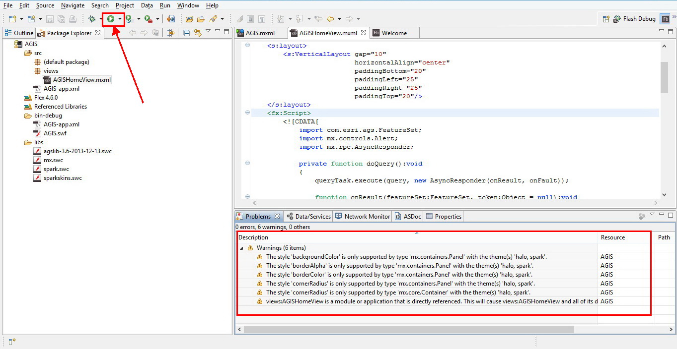

MVP Emeritus
Hani,
   Also the Warning you are getting can just be ignored. They are there because of importing the mx.swc (which is necessary).

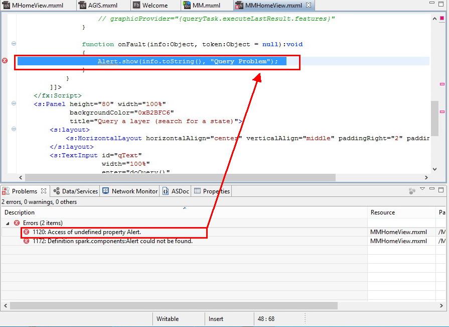

1120: Access of undefined property Alert
1172: Definition Spark.components: Alert could not be found
an when I run the app and proceed the errors, it starts with a blank screen.
MVP Emeritus
Hani,
   Sorry, That is because I am using Flex SDK 4.13.0 that has an spark version of the Alert. You just need to remove the spark.components.Alert and replace it with mx.controls.Alert;
