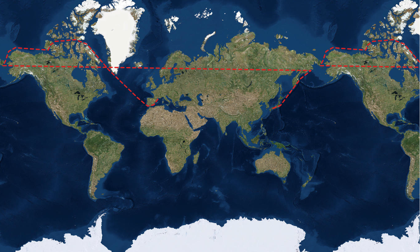

we will get path like this one:
It is not what we exactly want to achieve because our intention was to cross International datetime line. But from perspective of given to us API... everything works correctly For listed above MapPoints, algorithm insinde WebMercatorUtil.geographicToWebMercator method understands that it should return coordinates for single world instance - and that is what it is doing exactly.

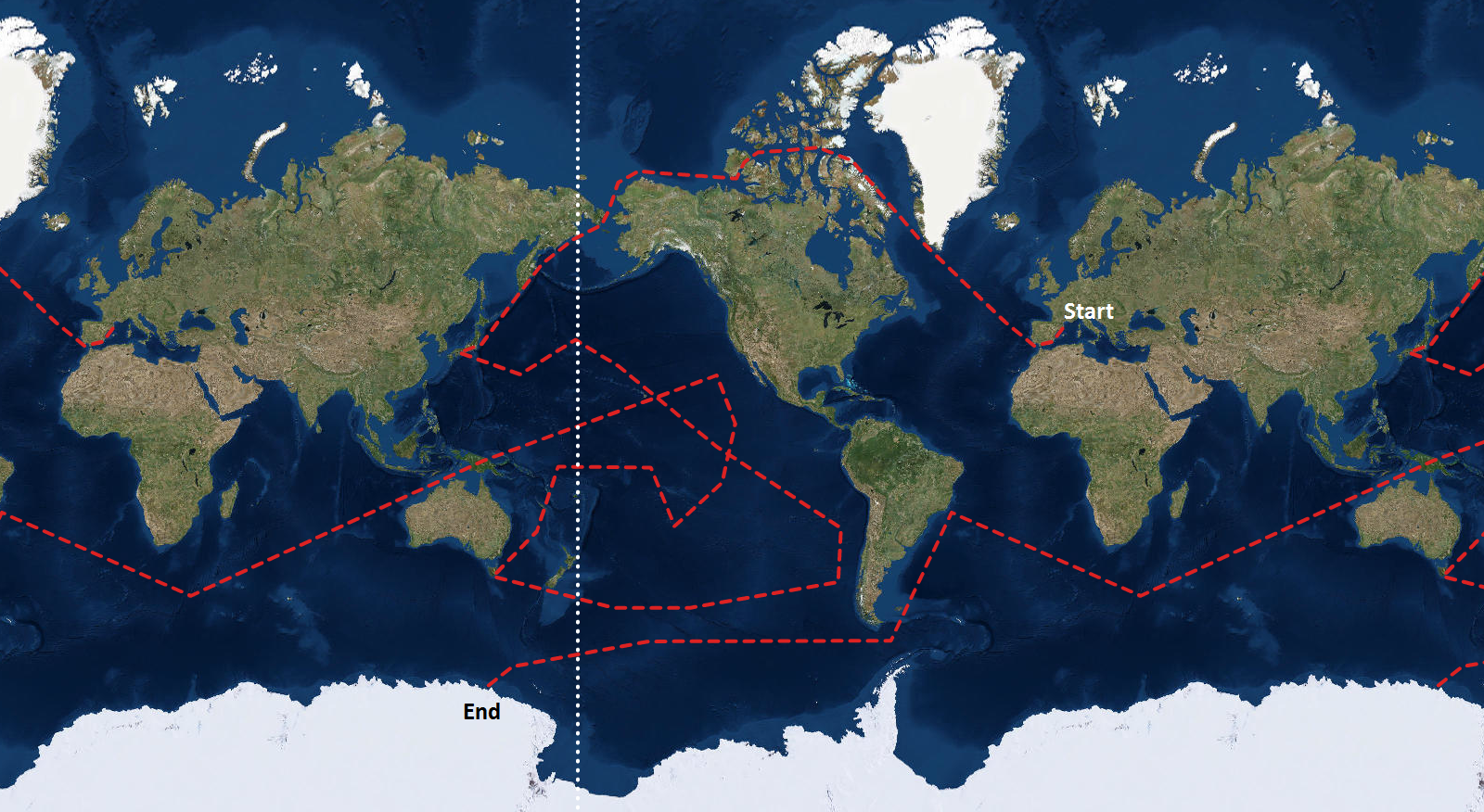

So whenever we want to cross a datetime line - we just have to add calculated offset to 180 (when we are going in RIGHT) or subtract it from -180 (when we are going in LEFT direction). With such approach - it is very easy to draw really complex shapes like this one (the white dotted line in International dateline):
Knowing how this stuff works - this should be right now very easy for any developer to draw a complex shapes on the map wrapped around the world I hope that it will help some people
