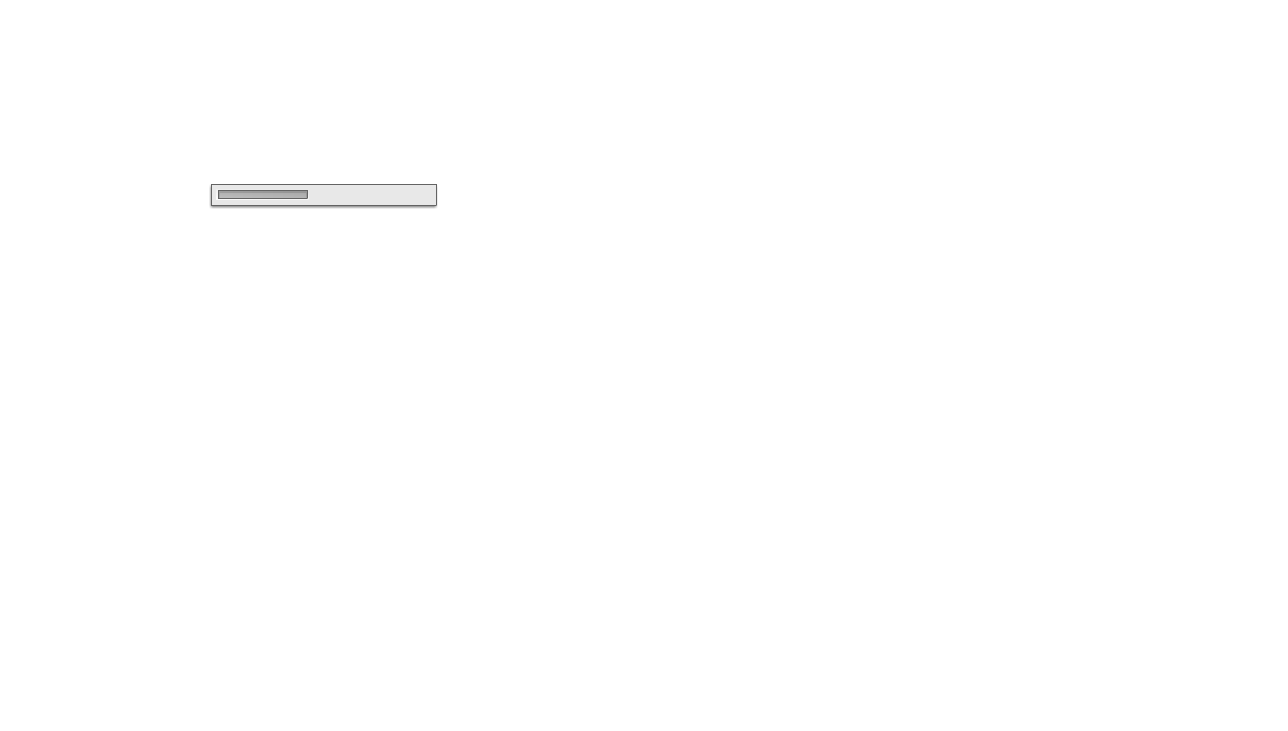

Hello,
i am trying to put customize logo instead of default loading for esri viewer for flex, any help would be greatly appreciated. thanks
PFB the default loading screen i want to replace with some logo.
Reagrds
Saurabh

Saurabh,
   In the Index.mxml of your project.
<s:Application xmlns:fx="http://ns.adobe.com/mxml/2009"
               xmlns:s="library://ns.adobe.com/flex/spark"
               xmlns:viewer="com.esri.viewer.*"
               xmlns:managers="com.esri.viewer.managers.*"
               pageTitle="Parcel Viewer Flex Version"
               preloader="com.calhoun.county.CalPreloader">

Saurabh,
    This is the link that I used to learn how to do this.
Building a custom Flex preloader | Adobe Developer Connection

SaurabhGupta5
Wow, i got it correct from your help but only one concern how to use customized image instead of displayloader(swc). i want to use image . please suggest . Thanks

SaurabhGupta5
HERE IS THE SOLUTION..
// ActionScript file
package com.esri.viewer
import flash.display.DisplayObject;
import flash.display.MovieClip;
import flash.display.Sprite;
import flash.events.Event;
import flash.events.ProgressEvent;
import flash.text.TextField;
import flash.text.TextFormat;
import flashx.textLayout.tlf_internal;
import mx.core.mx_internal;
import mx.preloaders.SparkDownloadProgressBar;
import org.as3commons.lang.Assert;
use namespace mx_internal;
public class Preloader extends SparkDownloadProgressBar {
  [Embed(source="assets/images/loaderlogo.png")] public var logoClass:Class;
  private var preloaderLogo : MovieClip;
  private var loadingText : TextField;
  private var loadingProgress : TextField;
  private var _initProgressCount : uint = 0;
  private var textFormat : TextFormat = new TextFormat("Verdana", 16, 0x666666, true);
  public function Preloader() {
   super();
   textFormat.align = "center";
  override public function set preloader(value : Sprite) : void {
   super.preloader = value;
   if (!preloaderLogo) {
    var img:DisplayObject = new logoClass();
    preloaderLogo = new MovieClip();  // kakaranet logo
    preloaderLogo.addChild(img);
    var startX : Number = Math.round((stageWidth - preloaderLogo.width) / 2);
    var startY : Number = Math.round((stageHeight - preloaderLogo.height) / 2);
    preloaderLogo.x = startX;
    preloaderLogo.y = startY;
    loadingText = new TextField();
    loadingProgress = new TextField();
    loadingText.width = stageWidth;//to allow center align
    loadingProgress.width = stageWidth;
    loadingText.text = "Loading...";
    loadingText.y = preloaderLogo.y + preloaderLogo.height + 20;
    loadingProgress.text = "0%";
    loadingProgress.y = loadingText.y + loadingText.textHeight + 10;
    addChild(preloaderLogo);
    addChild(loadingText);
    addChild(loadingProgress);
    loadingText.setTextFormat(textFormat);
    loadingProgress.setTextFormat(textFormat);
  override protected function progressHandler(event : ProgressEvent) : void {
   super.progressHandler(event);
   if (loadingProgress) {
    loadingProgress.text = Math.floor(event.bytesLoaded / event.bytesTotal * 100) + "%";
  override protected function completeHandler(event : Event) : void {
   loadingText.text = "Ready!";
   preloaderLogo.stop();
  override protected function initProgressHandler(event : Event) : void {
   super.initProgressHandler(event);
   //similar to super
   _initProgressCount++;
    loadingProgress.text = "100% / " + Math.floor(_initProgressCount / initProgressTotal * 100) + "%";
