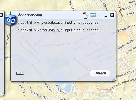

have a problem with the ArcGis Viewer for Flex. I have a model it calculates minimum and maximum of raster datasets. If i share with the Flex and add the geoprocessing service to a widget, after if i try to run the widget it has a warning message:RasterDataLayer is not supported
I tried with grid, and tif format but the warning message is the same.
I am usinf Flex 3.0
RobertScheitlin__GISP
MVP Emeritus
Laszio,
    RasterDataLayer input support was not added until 3.3 of the API. You need to update your Flex Viewer version to allow support for RasterDataLayers
In version 3.3 raster data layer support was added
