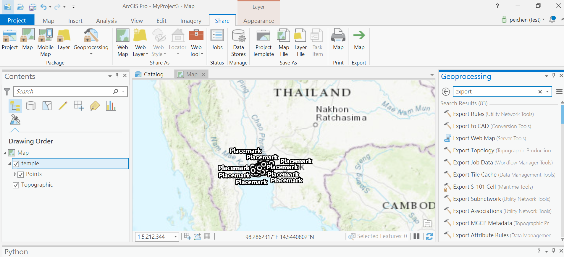

Hello, I want to get .sbn and .sbx files,
however, I couldn't get these files from qgis,
so I download arcgis pro.
I saw the article said that I could get these files  from arcGIS pro by import kml file and export as shape file,
will with the .sbn and .sbx file.
However, I couldn't find the way to export as shape file,
please help me!
or is there other way to get .sbn and .sbx file?
and the attachment is the file I use.
thanks a lot!!

Hi,
In ArcGIS Pro, you will first want to perform the geodatabase tool of KML to Layer to take your KML to a Geodatabase feature class:
KML To Layer—Conversion toolbox | ArcGIS Desktop
After that, you will want to export your feature class (layer) to a shapefile. Or just perform the geodatabase tool of Feature Class to Shapefile:
Feature Class To Shapefile—Conversion toolbox | ArcGIS Desktop
