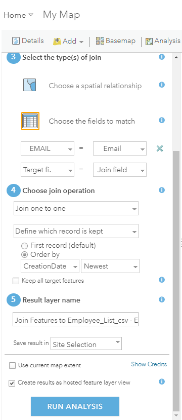

1. Bring your hosted Manhole layer and your Survey123 Inspection into a map with ArcGIS Online or Enterprise
2. Click on the “Analysis” tab nest to add data and the basemap selector
3. Select summarize data
4. Select Join features
5. (1) For your target layer select your manholes
6. (2) For the layer to join to the target layer select your Survey123 data
7. (3) Select choose fields to match (Manhole/ Asset ID)
8. (4) Select “Join one to one”
               "Define which record is kept"
               "Order By"
               "Creation Date" and "Newest"
9. At the bottom there is a checkbox for “Create results as hosted feature layer view”
               -Selecting this will create a dynamic join where only the most recent inspection will show.
               -Not selecting this will create a static layer based on the current data that will need to be recreated every                  time new Survey123 inspections are created (Not Recommended)
Screenshot
