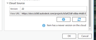

When I have loaded a rvt file to a  scene in Pro via a BIM cloud connection, I am able to check if the rvt file is updated. If a newer version is available, I can download the source file.
But after downloading the version number is not updated and therefore ArcGIS Pro keeps saying a new version is available. Removing and adding again the rvt file via the BIM cloud connection does not solve this.

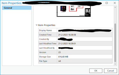

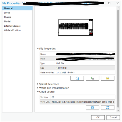

When I check via a BIM connection in Pro the properties of a file i.e. it shows me the version that I also see in BIM360:

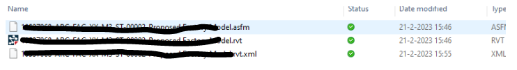

In Pro the rvt file local to be updated:
Stefan_Thorn_1-1677060164142.pngStefan_Thorn_1-1677060164142.pngStefan_Thorn_2-1677060200190.pngStefan_Thorn_2-1677060200190.png

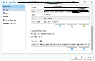

Before start 'Download the source file from the BIM cloud and overwrite local file':
After start 'Download the source file from the BIM cloud and overwrite local file':
Properties in Pro after Download:
The local rvt file is updated but the metadata is not:

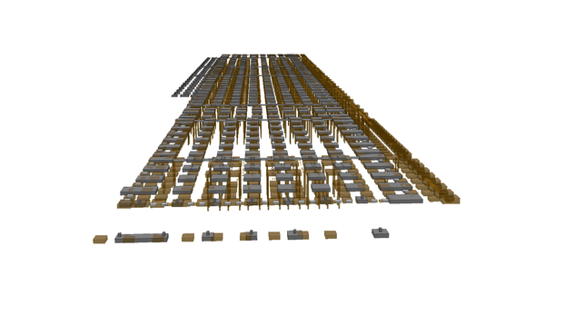

orange V22 (slpk)
Grey V23 (rvt)
