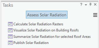

I think the answer you're looking for can be found in our Calculate Solar Radiation solution, which is an ArcGIS Pro project package (.ppkx) that contains workflows to calculate, visualize, summarize, and publish solar radiation results for selected roofs. The package contains 4 different tasks that will walk you through each workflow, including Summarize Solar Radiation for selected Roof Areas, which could be the tool you need.
