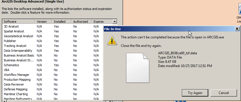

Thanks for the suggestion Jayanta. I tried to clear the Trusted Storage files and I was able to clear all but 1 of the tsf.data files.  One of the files wouldn't let me move it to a new destination, giving an error because it thinks it's "open in ARCGIS".
I tried to rectify by shutting down and restarting - that didn't work  (see right menu below).

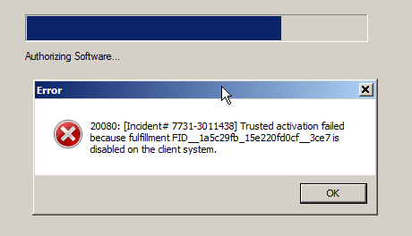

Then, I tried to go ahead and re-authorize anyway (see left menu above)- seemed promising, but that didn't work either. This is the error message.

You could "End Process" the ArcGIS.exe from Task Manager, and then try deleting the trusted storage.
This is a known bug in ArcGIS 10.0. But it couldn't be addressed as the product got retired.
NIM081072: When attempting to authorize a license, the following error message is received: "Trusted...
Since you received the bug with ArcGIS 10.5, You should consider contacting Esri Technical Support to resolve the issue. Resetting the authorization codes by Esri Technical Support might just work for you.
