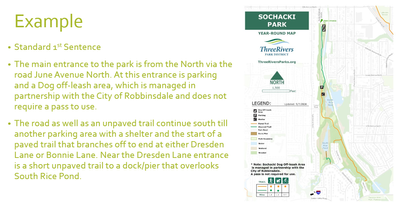

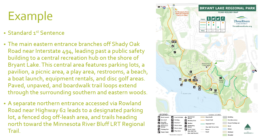

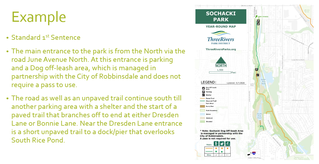

We have a few examples but we're just not sure what the industry standards are or if industry standards for park maps even exist, so we thought we'd reach out here.

In your examples, I would consider the text that is written could be provided as a caption rather than the alt text. This would allow people without visual impairments to also read and understand the intent of the map and the information that is being communicated, which could help people with cognitive impairments as well.
