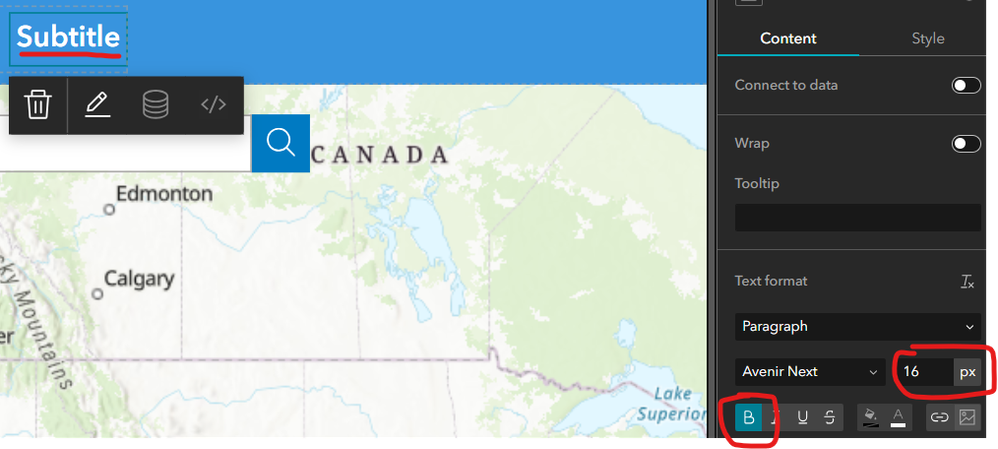

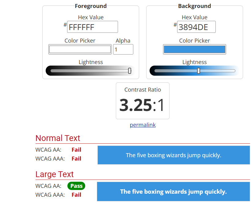

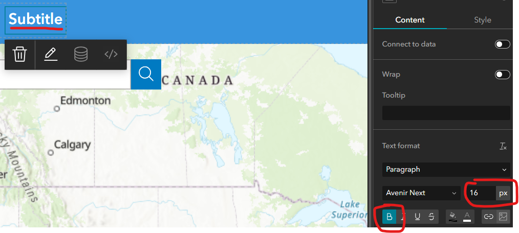

So I started a new Experience Builder app from scratch to test this using the Create New - Foldable template. I went to Theme and picked Ocean. And then I used https://webaim.org/resources/contrastchecker/ to check the subtitle:
Oh, well, it passes for "large text" - that's what the default subtitle is, right? Wrong:
"Large text is defined as 14 point (typically 18.66px) and bold or larger, or 18 point (typically 24px) or larger."

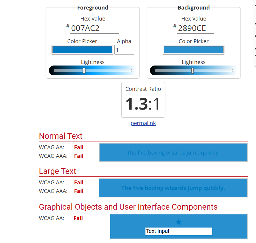

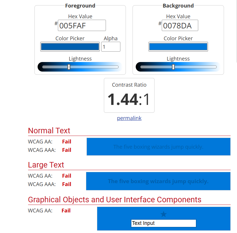

Then I checked the icons for legend, map layers, and basemap gallery that are added automatically in this template. This looks bad to me and I don't have color accessibility issues.
At least the white icons within the blue box meet the contrast requirements.

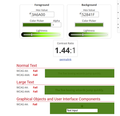

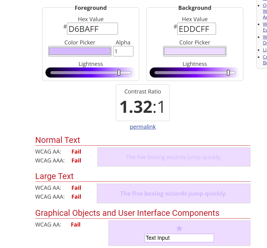

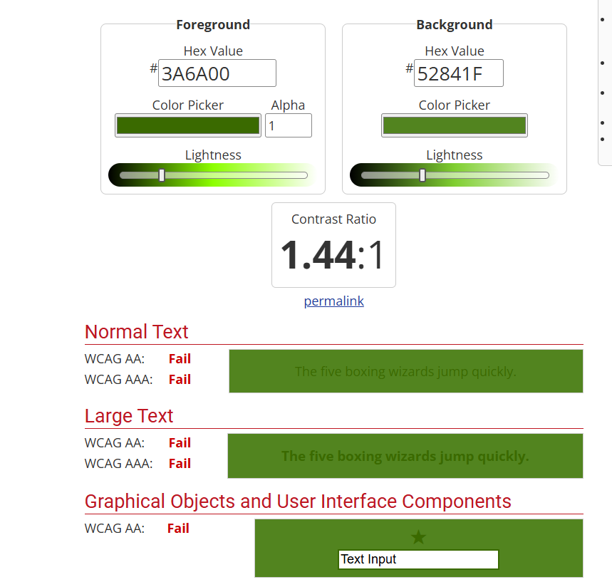

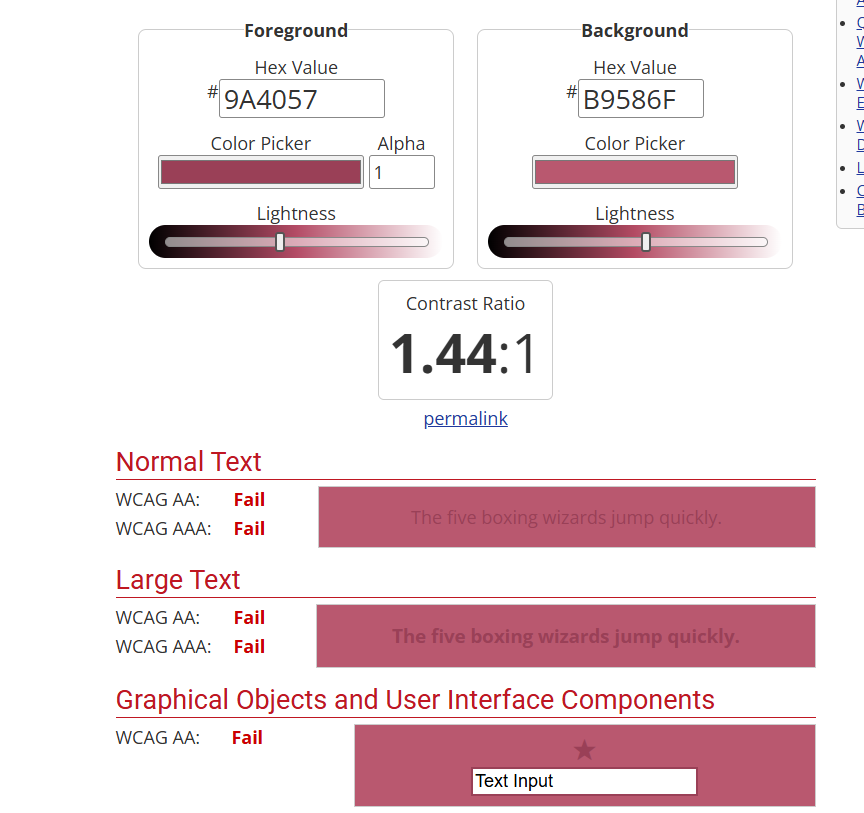

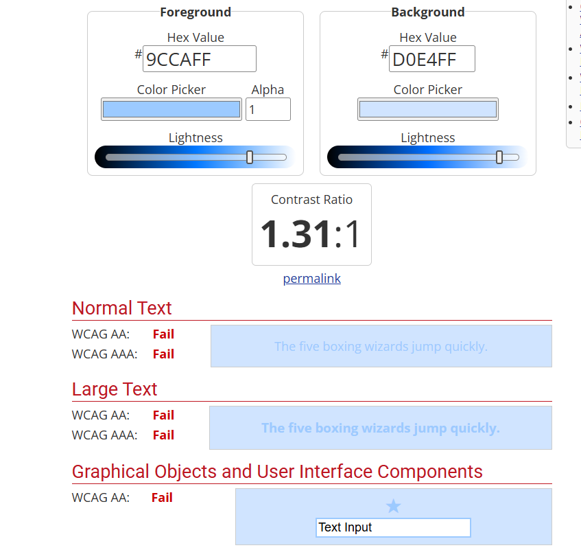

And so I checked Astro:
Prime:
Velvet:
Abyss:
Calcite:
Meadow:
All failing for graphical objects and user interface components.

I think as long as your heading is bold (which it is in your picture) you should be fine. large text on that website appears to just be bold text. That doesn't mean they can't/shouldn't increase the size.
