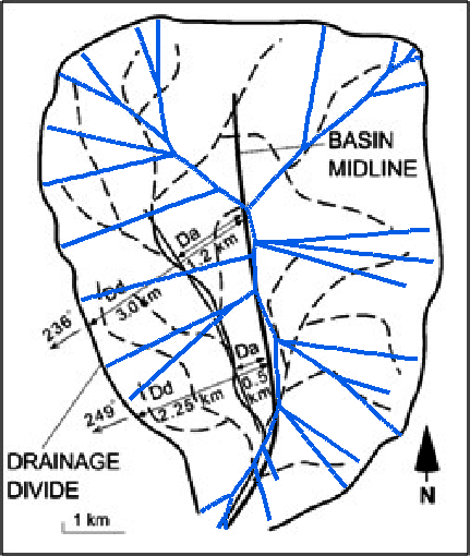

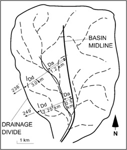

 I am trying to calculate topographic symmetry. For this need to have a distance between mid line of a basin to streams and divided, like shown in Figure.
any one please let me know how to draw a mildline of basin in Arcmap.
