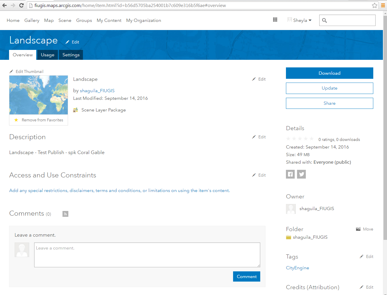

SheylaSantana
If this bottom does not appear is it because I don't have permission? It should be next to this "download", "update" and "Share" bottom, right?
Does ArcGIS Earth spk file?

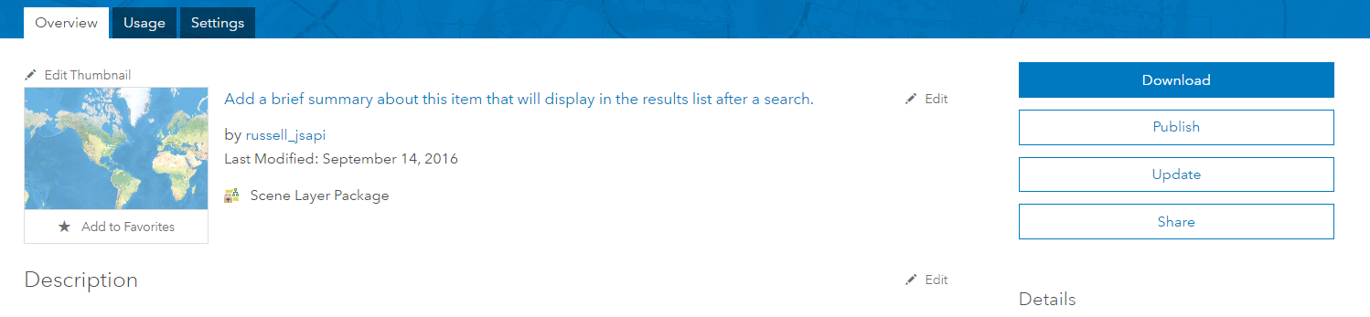

RussRoberts
Esri Notable Contributor
Yup, you will want a role with the ability to publish scene layers
when you do, the item details page will look like this.
