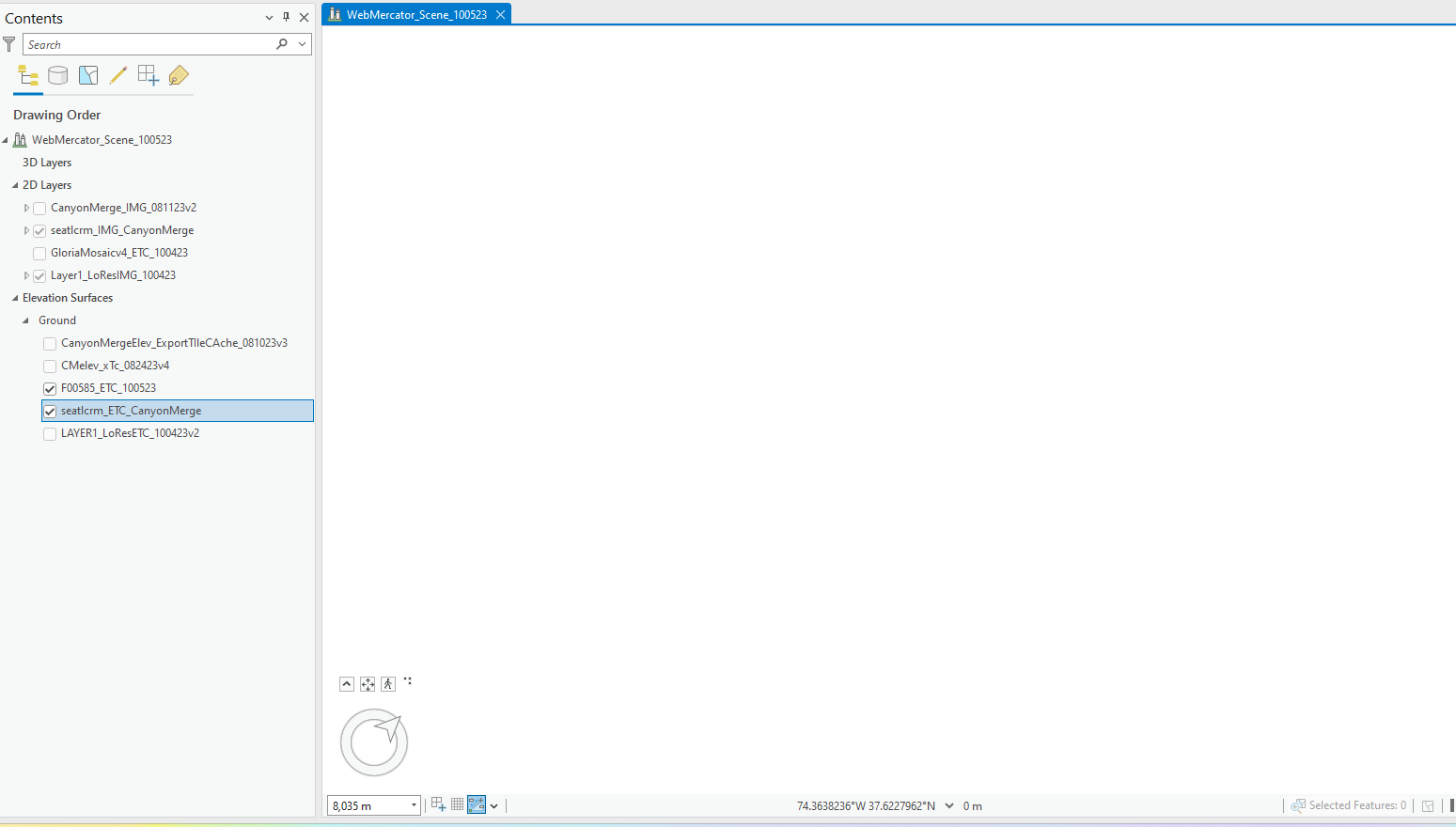

Image 1a - 8035m above 3D terrain - No tiles in terrain model are visable (desite caching tiles a Level 20 in the scale)

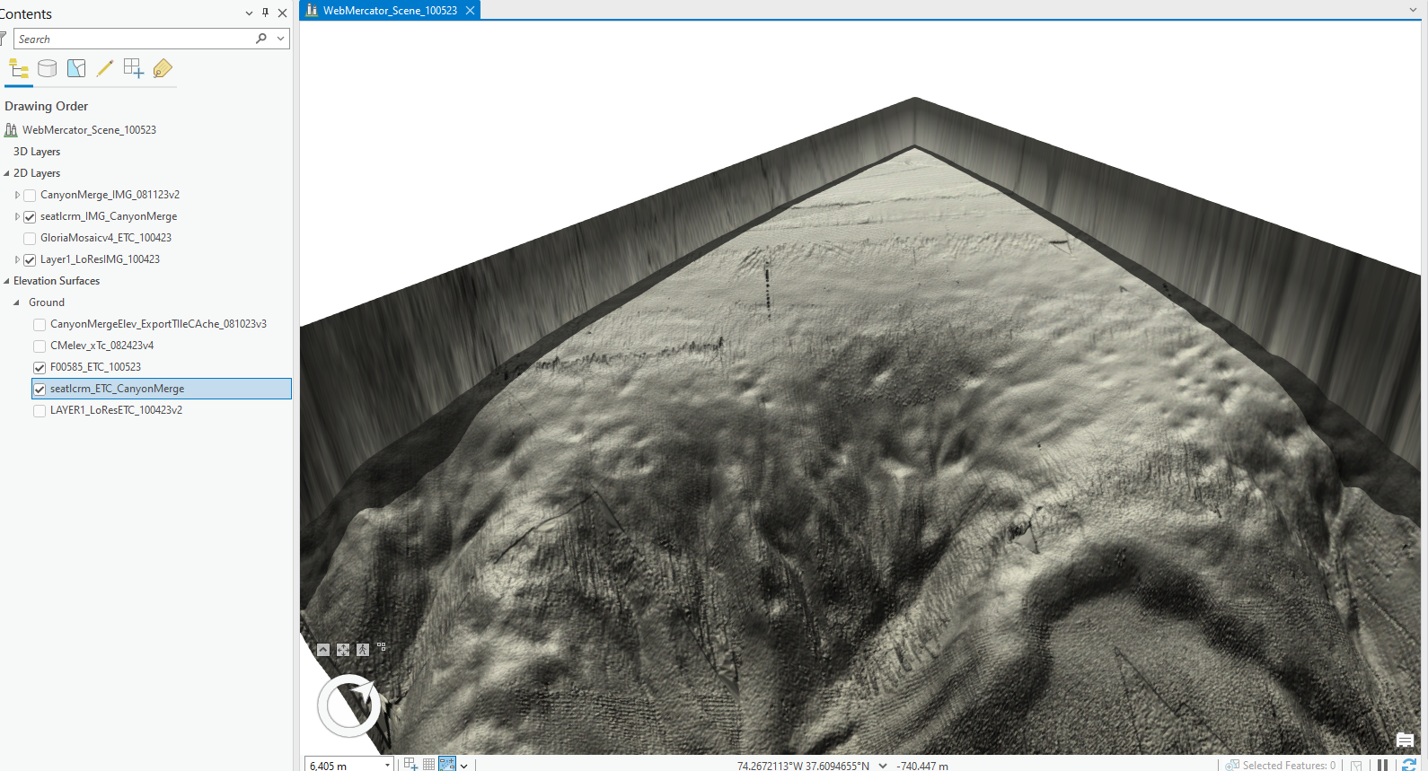

Image 1b - 6045m above terrain, half the tiles in the area in focus display with the upside-down V wall at cut off point.

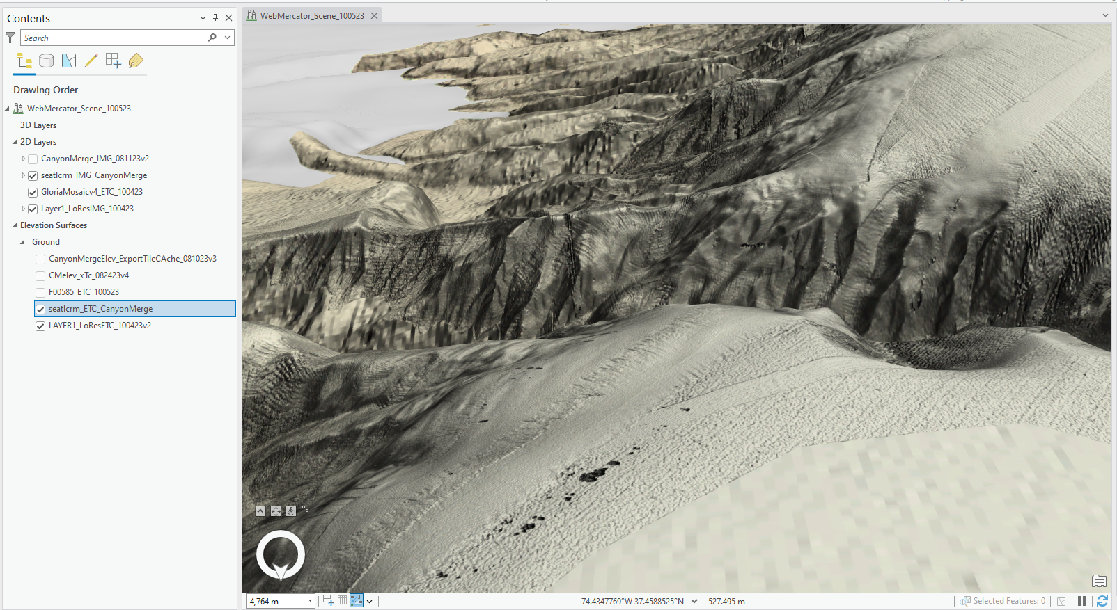

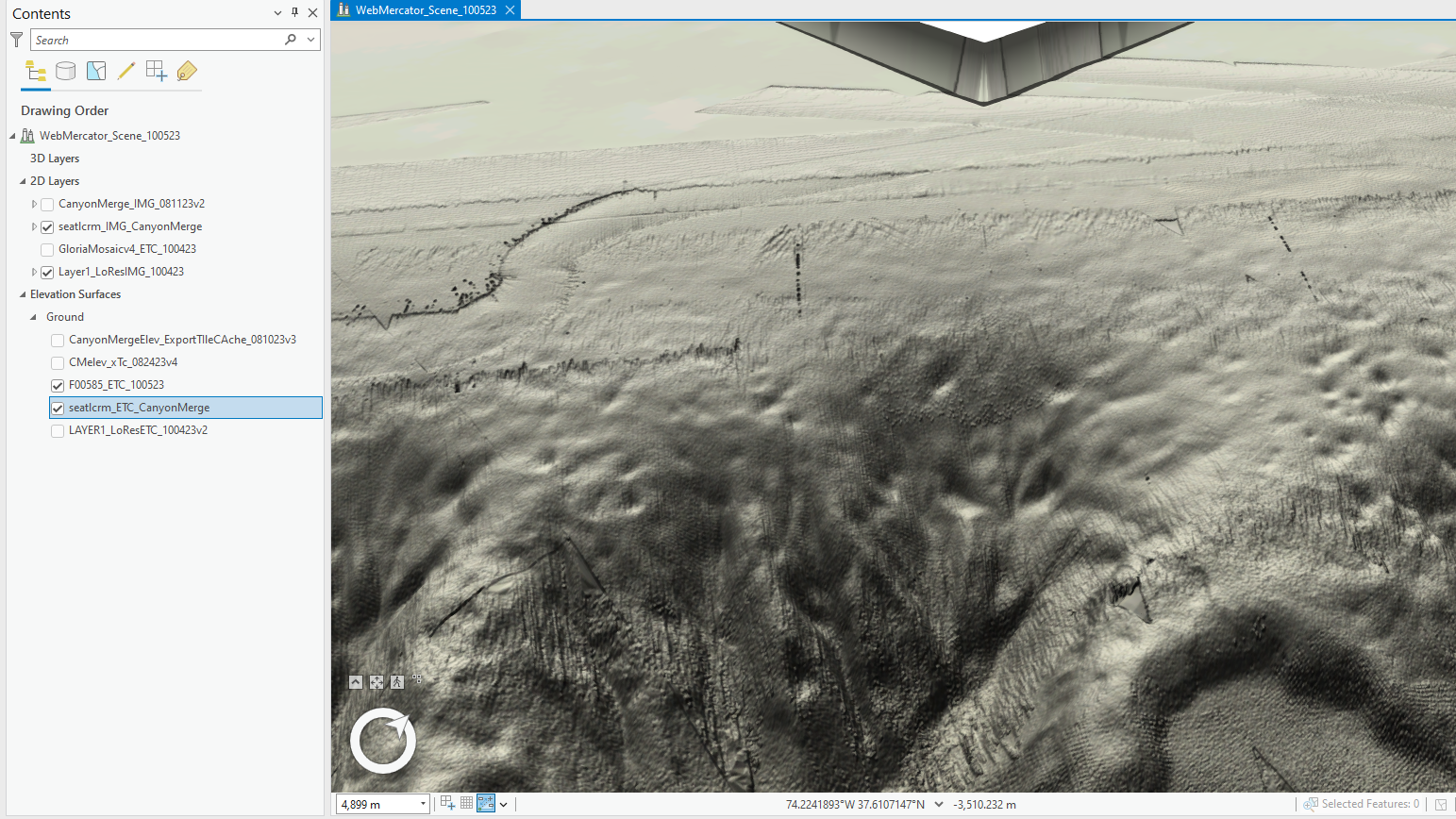

Image 2a - 4764m above terrain, shot taken over seemingly stable area of model.

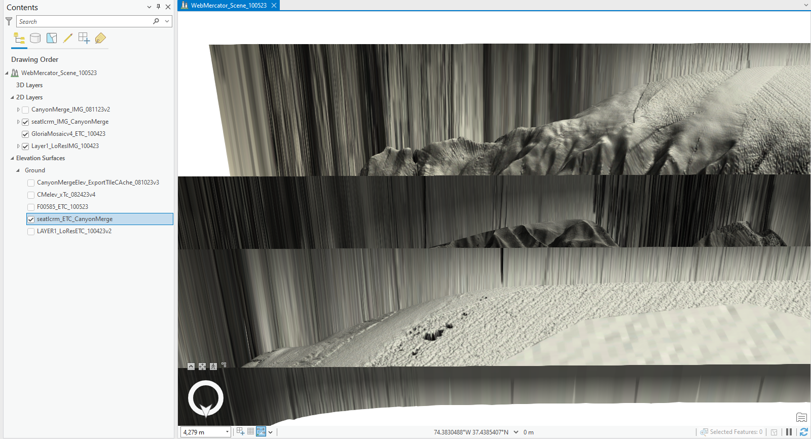

Image 2b - 4279m above terrain - zoom in a few hundred meters and the entire area in focus show many missing tiles and walls shoot up everywhere.

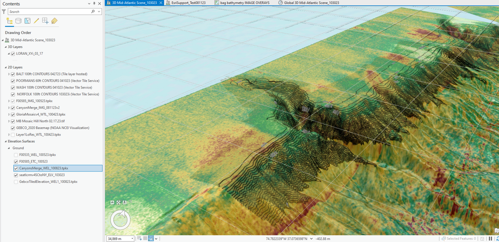

Thanks for reaching out and offering to help with my 3D issues. I've seemed to tamp down the erratic behavior with tiled block shoot up all the scene, but that was just an impediment in the road to the goal of getting my custom elevation layers (in my ArcGIS Pro scene) to somehow make it to the point where it can be used to create a mobile app (offline) showing the true elevation and bathymetric seafloor features which my scene is designed to highlight. Problem is that as soon as the scene crosses over into AGOL, the large-scale elevation characteristics of the bathymetry and the high-resolution details defining specific seafloor features is dropped and I end up with a relatively flat and featureless, blurry layer that was high-resolution and super defined. That carries over to all the app builder tools that Esri has and pretty takes away all the unique 3D attributes the scene and mobile app are supposed offer the end user. It makes no sense to me why this is functioning as designed, because it acts in a manner that absolutely destroys a 3D scene.

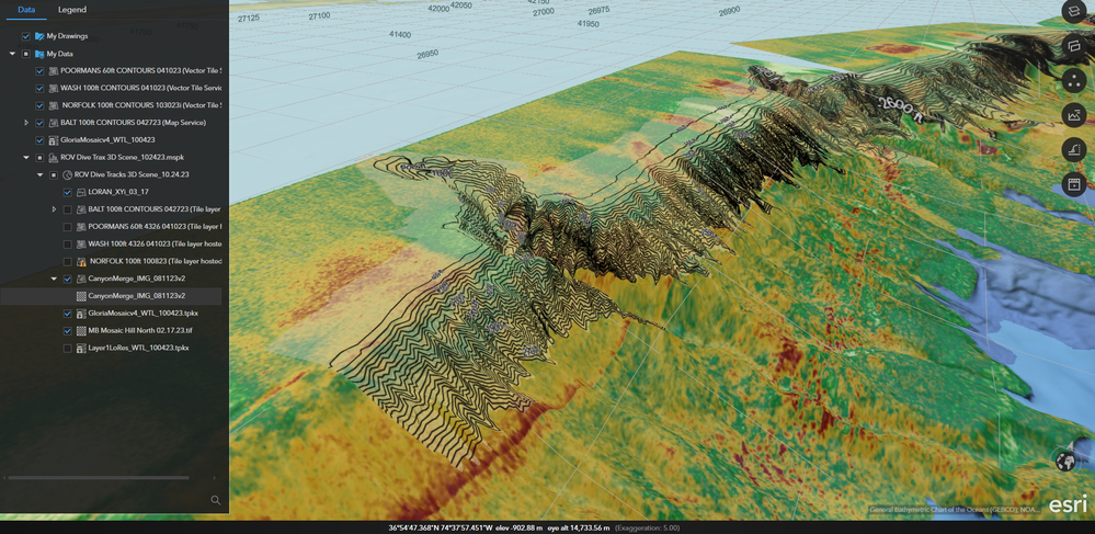

I've been testing my data (mspk, tpkx & tif layers) in ArcGIS Earth Desktop and ArcGIS Earth Mobile (both the the latest release version and the latest beta version). Though I see the large-scale elevation and hi-res attributes showing in ArcGIS Earth Desktop, the layer order has changed and I can't move layers up and down in a mspk in ArcGIS Earth Desktop. The result is my 2D image/symbology layers defined in ArcGIS Pro are not layered in the appropriate order, so the blending and transparency settings aren't applied. The symbology depicts seafloor hardness, so now it's just the color scheme that the Stretch colormap selected.

ArcGIS Pro Scene (top) / ArcGIS Earth Desktop (bottom) ArcGIS ProArcGIS ProArcGIS Earth DesktopArcGIS Earth Desktop

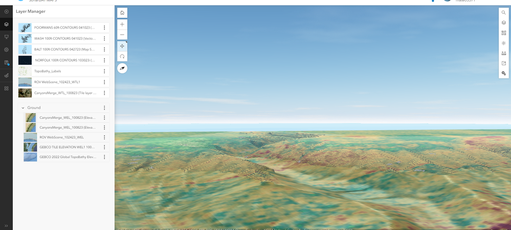

This is what my scene looks like in ArcGIS Scene Viewer and any app that requires a Scene to be hosted in AGOL before it can be imported into a 3D app template. I don't understand how how 3D apps are createrd if AGOL stips the elevation values from the scene? How is this possible? It's not a 3D scene anymore, this is the question I've been trying get answered for a about year now.

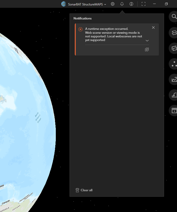

I have gone through so many interations of creating and discarding layers while that my naming I"ve lost control of a logical naming convention system, the date/times of initial creation and the source of the sources. The mspk I shared with you failed to load to ArcGIS Earth Desktop this morning with the following message displaying in the application.
