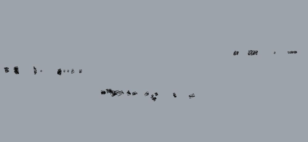

I tried running a Python script to read only the first 50 subfolders in the Export 3D Objects folder. (from my earlier 'export 3D' attempt that I had to abort - which made 76,000 folders with OBJ and JSON)
I do understand schematically what needs to happen, but I'm not that good at coding, so I instructed ChatGPT to write a script. I do acknowledge that the .JSON file contained a huge value for coordinates - perhaps meaning that it is marking a global location. So - I specified the script to use the location of the bldg in the first folder as an origin and all the other bldg to be relatively located. I was able to run the script, no errors, it merged 50 obj files into one obj file (via text only), and I was able to import that .obj file into Rhino3D which is what I normally use.
However, the script fails to locate the buildings correctly. It seems to cluster the buildings in a strange manner, sort of along X axis. Intuitively, it seems to either lack the Y axis offset information or using a different scale for Y axis. (screenshot below)
I feel like if I can correctly understand each field of the json file and figure out the way to translate it correctly, this might work. I'm wondering if you could (1) spare some time to discuss it directly with me (pls. email me: [email protected]), or (2) share part of your python script showing how it handles the location conversion...
In the meantime I think I'll re-run the export3D for a few days, but I want to get this workflow right, since this might be my only option...
Thank you for your attention!
