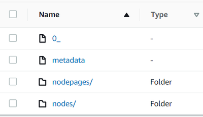

Still hitting the same error. Using your example, is this what you would expect to see in /My_sceneContenet.i3srest?
