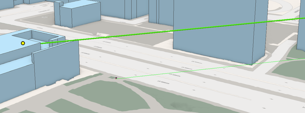

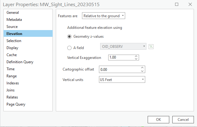

I'm trying to use the Line of Sight (3d Analyst) tool to determine new building obstructions.  I have a DEM assigned to my scene and I have target and observation point feature classes with elevation from a field that I used to create Sight Lines with the Construct Sight Lines tool.  The elevation of the Sight Lines is set to a geometry z value at "Relative to Ground" and all line up with their actual physical location.  When I run the Line of Sight tool the resulting feature class appears lower than my Sight Lines which causes erroneous "Not Visible" features and obstruction points to be created.  The Line of Sight feature class lines up exactly with my Sight Lines if I change the elevation setting to "At an Absolute Height" but then they would be in the wrong location (lower).  How do I force the tool to use the correct elevation setting? Any suggestions or input greatly appreciated.
Line of Sight Tool parametersLine of Sight Tool parametersSight Lines elevation settingSight Lines elevation settingLine of Sigh tool output is thin green line hitting the ground and Sight Line is thick green line above in correct location,Line of Sigh tool output is thin green line hitting the ground and Sight Line is thick green line above in correct location,
