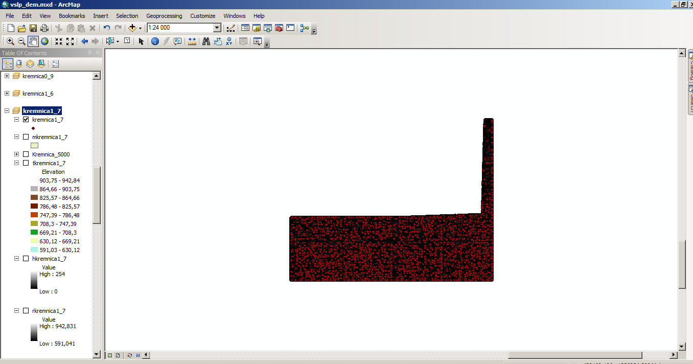

hello friends, i imported las file into arcgis - looks like this...

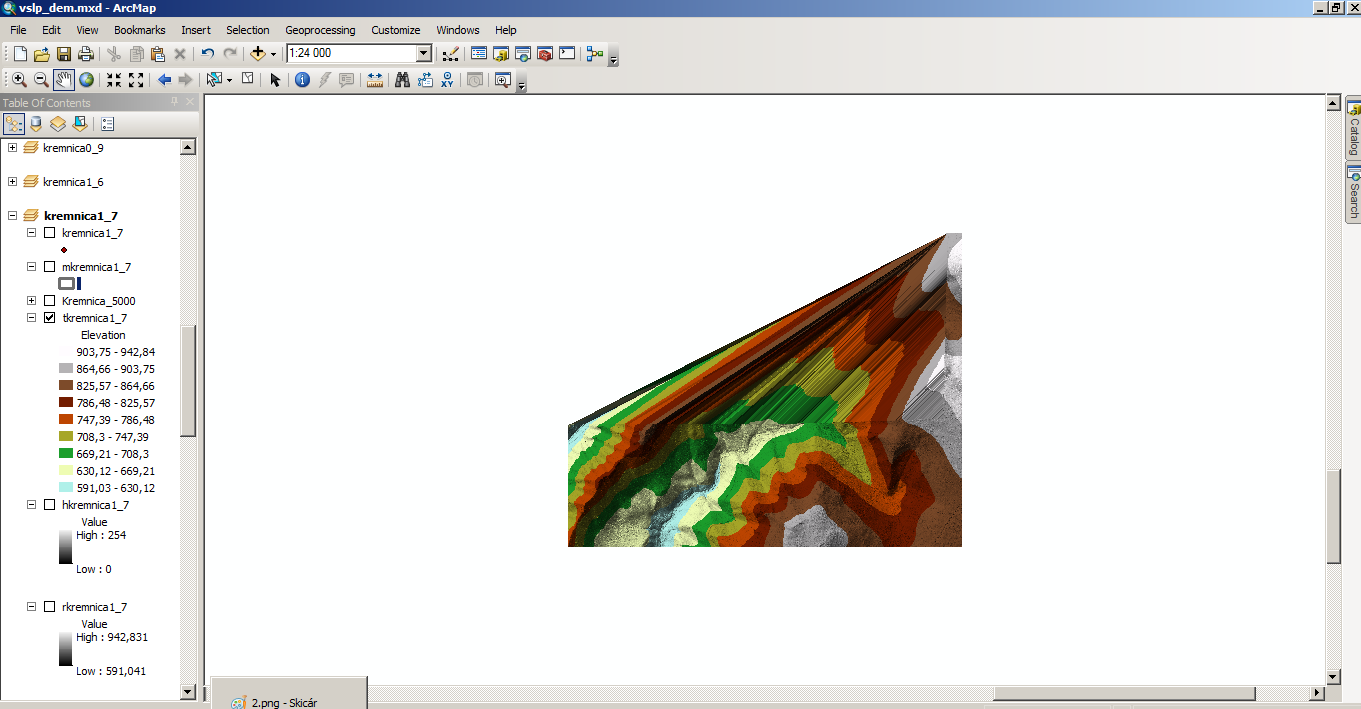

can somebody help me with that please? thank you so much...

dump the points in the pointy section or window it, or mask it, otherwise the tin is the correct intpretation of the points LAS Dataset To TIN—Help | ArcGIS for Desktop

that´s wonderful! thank you so much
