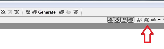

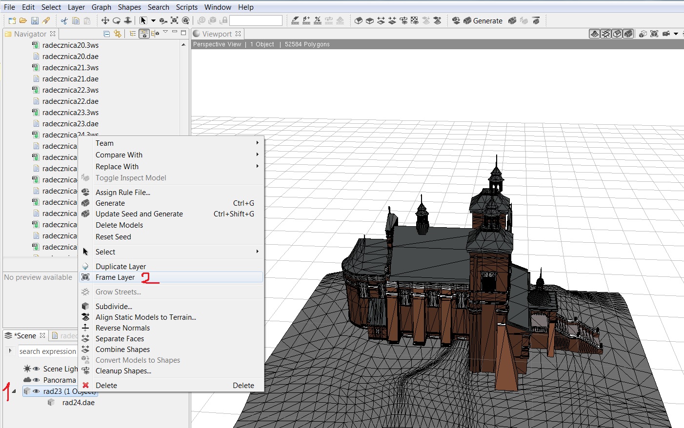

Hello Colin,
shortcut key "F" or Viewport menu --> icon from my second screen
