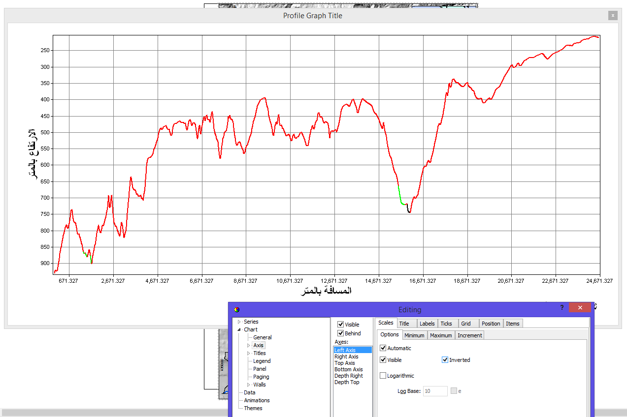

AbdelhakEl-fengour1
Right click on the graph ---> Advanced properties---> Axis, and check inverted (see the picture)
