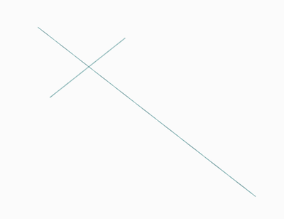

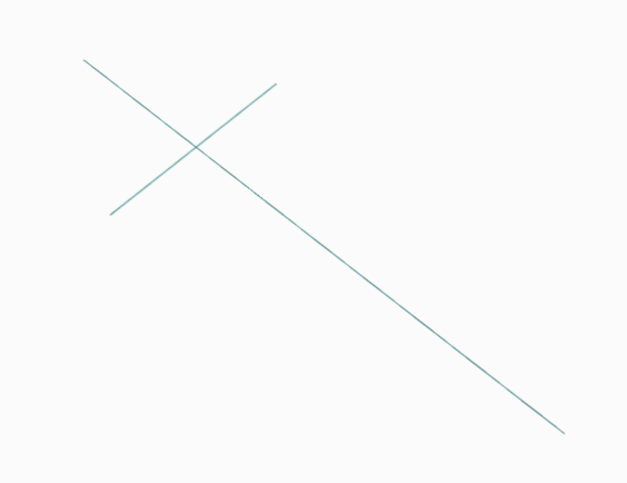

To give a better idea, these are the polylines:

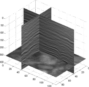

And this is an example of a couple of seismic section images to attach to the above lines within the scene:

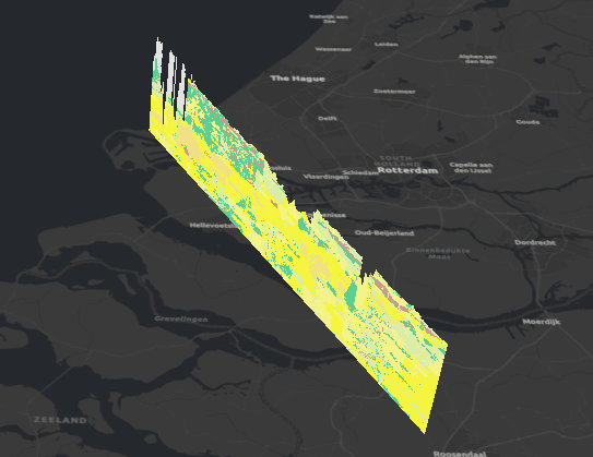

This is possible in ArcGIS Pro with the use of voxel layers by creating cross sections such as an example below.
Please find more information here: Voxel layer sections—ArcGIS Pro | Documentation
