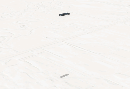

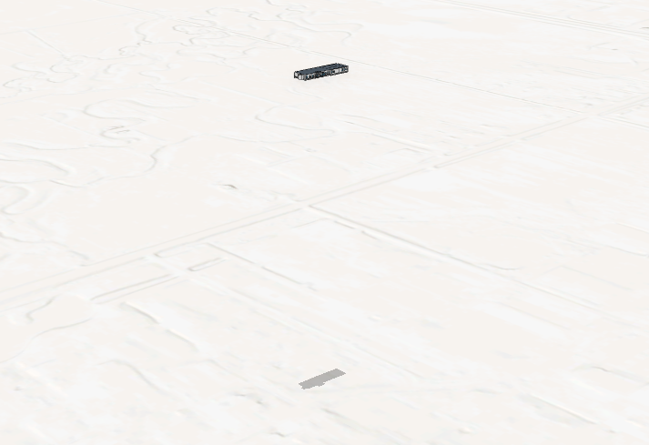

Hi, I was trying to georeference couple of revit models but no matter what I did, the model just didn't want to touch the ground. I tried "elevate to ground" but it would send the building higher in the sky; I also tried manually move the model down about where it should be but once I hit save, the building just shot itself up into the sky again.

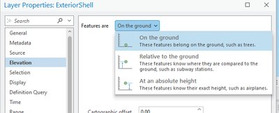

Prior to you click 'elevate to ground', did you turn on the snapping tool and snap to the bottom corner ( first floor\ground level) of the building?
If yes, I suggest you to check the Elevation setting in the Layer Properties. This setting allows you to define how the layer interacts with the elevation surface in a 3D scene, choosing options like "On the ground" to drape features onto the terrain.
