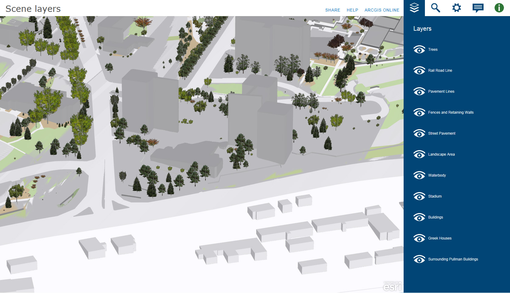

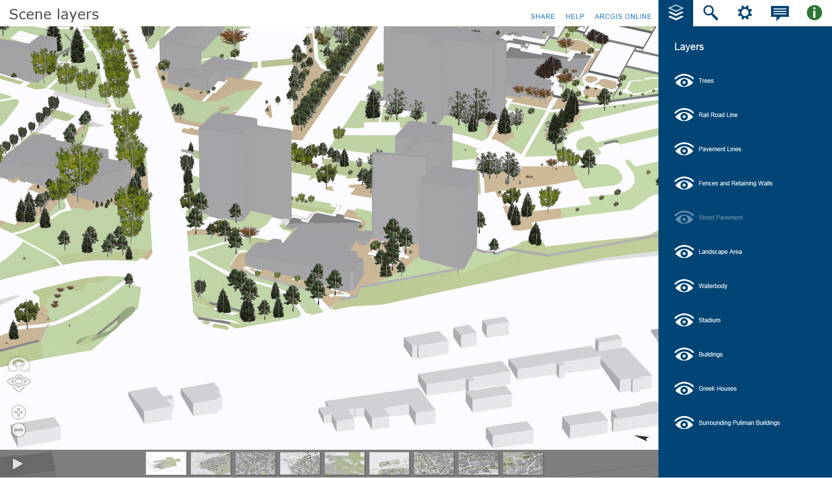

I have been putting together a 3D basemap for our campus, Washington State University, and have been trying to share my model using the export to 3d web scene arcToolbox tool.  For the most part is has worked pretty well except for my StreetPavement feature class (polygon).  For some reason, blank spaces in between polygons are getting filled.  In other words, the areas that would be filled by my LandscapeArea polygon class are being filled with gray polygons.  I have attached a screenshot to help illustrate.  If I turn off the StreetPavement layer in the web scene viewer it looks fine.  The strange this is that the LandscapeArea class doesn't experience this same phenomenon.  I have tried about twenty different things to the StreetPavement class, but always end up with the same result.  For example

I have even gone so far as to copy the features within the StreetPavement class and copying them into the LandscapeArea class.  The result ends up looking the same.  So I know the issue has to do something with the polygons in the StreetPavement class, but I have no idea what it is or what else to try.
Dark gray area filling in between polygons in the StreetPavement Class.
