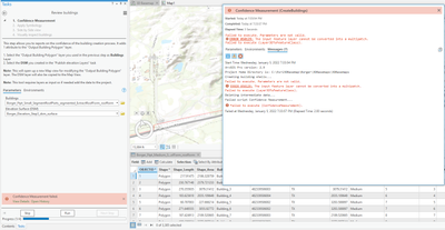

We are getting this error while running confidence measurement tool under "Review Buildings" task.
Here is a quick video of my screen.

Hello,
I´ve seen the similar error, the problem was that the input layer was among 2D layers and not among 3D layers group - when then layer was moved to 3D layers group and the tool run, it works fine.
Vladimir
