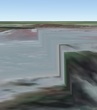

Rather than using the default Terrain3D as a ground layer for a Web Scene I would like to use some higher resolution data I have. The area of interest is irregularly shaped and the DEM resolution is 1.5 meters. I have been using the following workflow to prepare my tile layers:
Tool > Manage Tile Cache: Used to create a new tile cache. I tried using a feature class to define the AOI but this resulted in a blank output. Instead I left the AOI as default and traced around the feature class I wanted to use. The output looked good
Tool> Export Tile Cache: I used this to export the tile cache as a tile package layer.
Tool> Share Package: Although the output was under 1GB I still used this to upload to ArcGIS online because, well, why not.
In AGOL I move the tpk to a folder and published it. I then started a new scene (tried both local and global) and the result is that my new elevation layer works.... but gets cut off abruptly to the North. See the image below:
The extent is set correctly in AGOL but the auto-generated thumbnail is for the incorrect extent. I wanted to try it in ArcPro too to see if the elevation layer showed the same behaviour but instead Pro displayed a hellish minecraft inspired interpretation of the AOI. I have no screen shots of the ArcPro attempt as I deemed them too disturbing for general consumption.

Are you using the elevation layer along with the default elevation service? If you wanted to create a scene that uses your elevation to the same extent envelope you can create a local scene in Pro to the exact elevation extent and clip the extent to that and if you wanted to you can add the elevation layer in SV instead of in Pro.

So if you are using the 2 different elevation sources because they are at different resolutions and sources you can see these sharp edges where one elevation ends and the other begins when there are sharp differences.

I have tried removing the default ground layer and it sends everything haywire in AGOL and pro. Pan and zoom behaves erratically, and it often looks like there are two "worlds" with sections missing from the upper one. As shown in the screen shot below (in fact this one goes right through to space):
The sharp edges that exist I would expect given I am using two different ground layers. However, the sharp edges do not exist at the maximum extent of my custom elevation source. Instead they appear randomly. If it were only at the edges this would be expeted behaviour but as it isn't I suspect something else is wrong.
