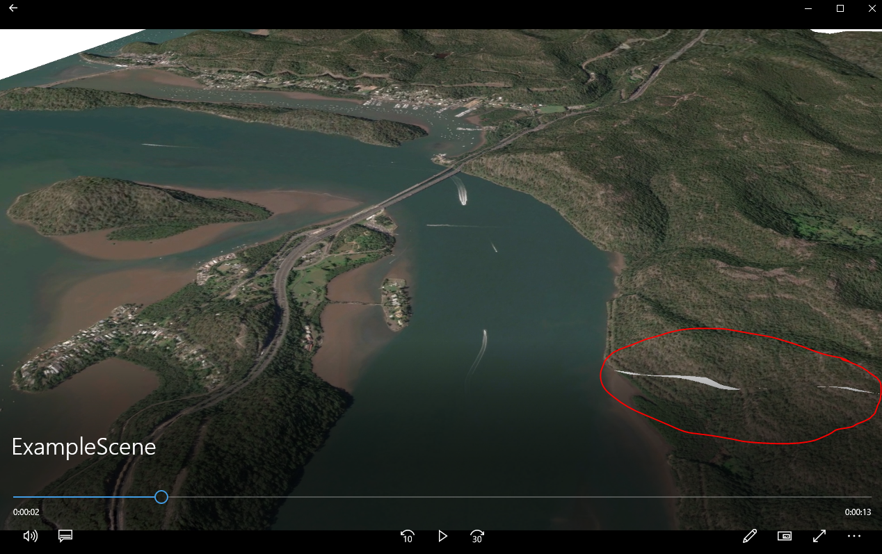

Example of gaps in 1080p:

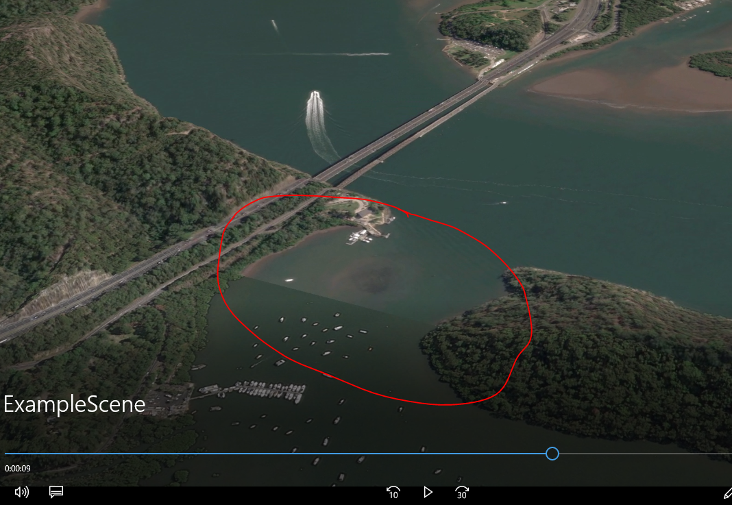

Example of basemap updating half way through in 1080p:
