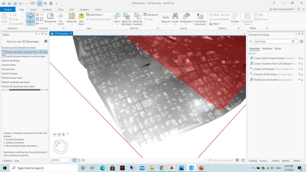

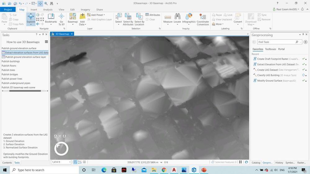

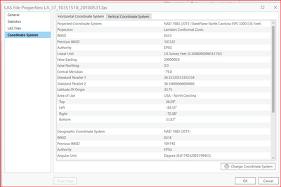

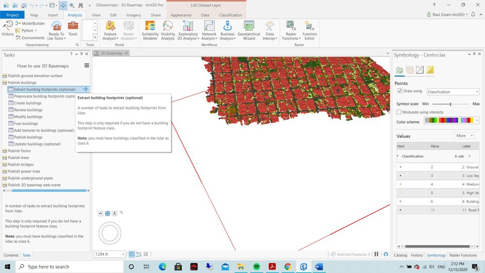

Hello, I'm having trouble using this tool, I think it has something to do with my point clouds coming from a Photometric program (Pix4d) and not from Lidar. I tried to do it in several ways, but it's either does not work or it marks different kinds of errors. Does anyone know how to fix this problem?
The first image is showing how when using it to extract the building footprint it turns out empty.
Building Footprint extraction emptyBuilding Footprint extraction empty
These other two images show how when using it to extract the elevation surfaces from the LAS dataset it kind of detects the buildings but still has lots of problems defining a polygon on the dtm, it processes the dsm totally empty and the dsm as just one big square polygon.
Error on extracting elevation surfaces from LAS Dataset (theError on extracting elevation surfaces from LAS Dataset (theZoom inZoom in

Hi Raul,
I had a look at your data.
The problem I think is that there are not enough ground points in this dataset so that ArcGIS can create a proper dtm. Also it seems a number of points are misclassified as ground because they seem part of a roof?

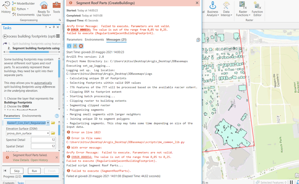

Hi, congratulations for your work with 3D basemaps.

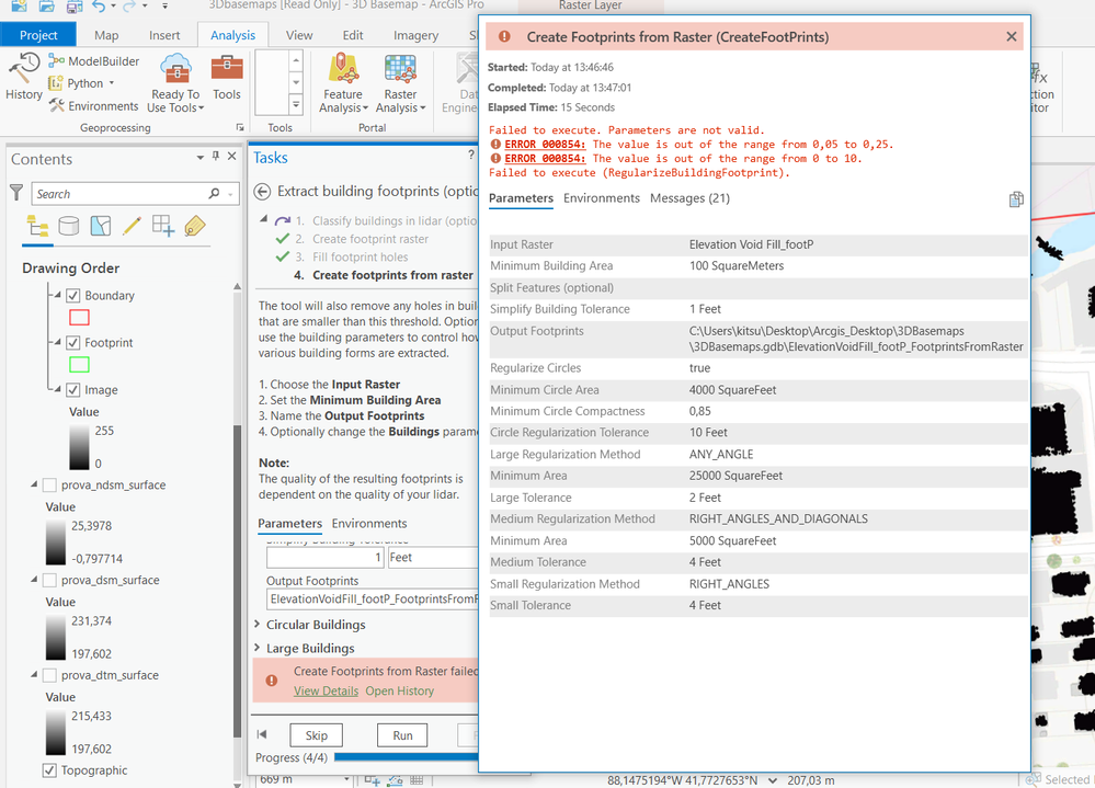

Unfortunately, I have a problem with a tasks:
- Segmenting building footprints using elevation
In "Segmenting building footprints using elevation" I get this error:
Error on line 1023
Error 000854
Here you can see an explanatory image.
How could this error be resolved?
I also encountered another error in: "Create footprints from raster".
Here an image.
I solved this last error/problem by using the following geoprocessing tools:
-LAS Point Statistics as raster
-Elevation Void Fill
-Con
-Raster to Polygon
-Regularize Building Footprint.
I don't know if the layer generated in this way could be a problem for "Segmenting building footprints using elevation".
Alternatively, is there a method for "Segmenting building footprints using elevation" using geoprocessing tools?
I am currently testing the solution with your example data.

Hi,
It seems odd that this happens with the sample data. Did you make a selection of a smaller area? In any case, it should work so I really would need to know exact steps (with all input data and input parameters) to be able to reproduce this error. Maybe you can make a small video that shows the steps taken with the sample data?
Regards Gert

Hi Gabriele,
Thanks for the videos. I managed to reproduce this and it has to do with the regional settings. I made some fixes in the code and it would be great if you could test this before our next release in June.
If you send me your email address, then I will send you a link to the updated solution.
Please use: [email protected]
Thanks Gert

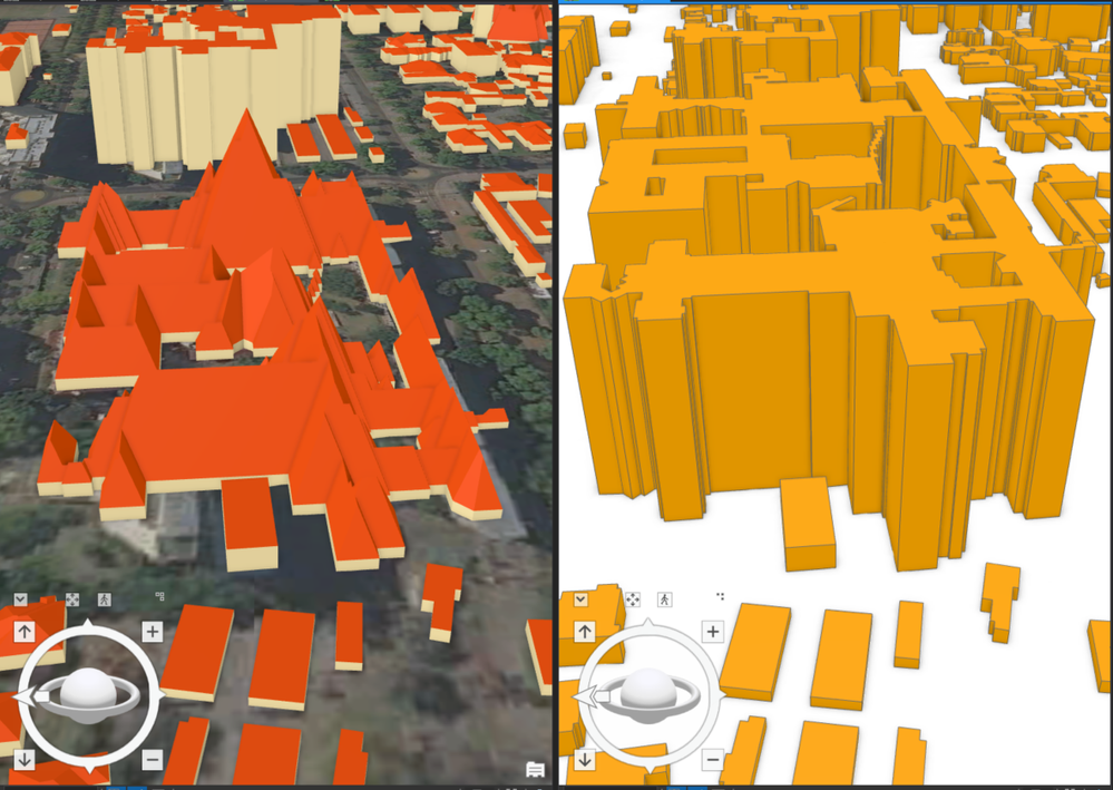

@Gert_van_Maren I have used the 3D basemaps solution to create 3D Building Multipatch, but my buildings fall into the ground  WHEN I include any elevation source? I discovered that the reason could be the elevation source is using different units (FEET) compared to the Building Multipatch Layer(METRES), If I select a single unit for all the layers, the buildings drop into the ground

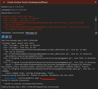

Hi Gert,
Thanks for the reply, this was helpful.  I had this error while publishing the power line work:
I had the same error when I went to publish two of the three underground sanitary sewer layers, the manhole layer published ok.  Same error as with the power line publishing.
The trench step failed as well:
I hope this helps.  Thanks, Jay
Gertvan_Maren1
Esri Alum
Hi Jay,
Did you convert the underground lines and power lines to multipatch features? It is part of the tasks and is necessary to publish.
Gert

I have created 3D Buildings Multipatch using the 3D basemaps solution (left image), but it fails to create tall/block of flats in some areas. @Gert_van_Maren @Gertvan_Maren1 Can you kindly assist on what I can do to improve this?11.05.2022_10.02.16_REC.png
Gertvan_Maren1
Esri Alum
Hi,
You will need to manually segment these building footprints according to areas of equal height. Then you can run the Extract Roof Form tool again,
Regards Gert

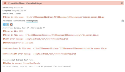

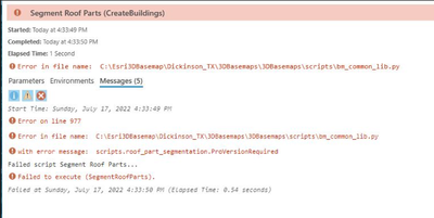

I am currently working on ArcGIS Pro 3.0.0 version and recently started a new project to create 3D buildings using the ArcGIS Solutions (3D Basemap).
While performing two following tasks, I am getting errors that I am not so sure how to solve.
Segment Roof Parts
Extract Roof Form
Can you please offer suggestions on how to resolve this?
Can it be related to the newer Pro version for which 3D Basemap Solution is not compatible? If yes, can you retrofit the 3D Basemap solution to work with the most current Pro version 3.0.0?
I would appreciate you looking into this promptly.

Hi,
Please download the lates release of the 3D basemaps solution which has support for Pro 3.0:
https://doc.arcgis.com/en/arcgis-solutions/latest/reference/introduction-to-3d-basemaps.htm

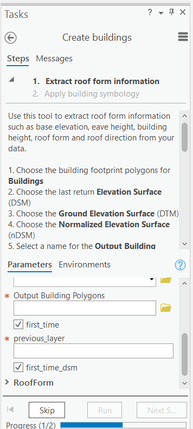

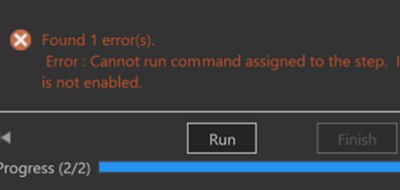

EBrayshaw
Hi !
Thanks for the solution.
I'm currently practicing with the Portland, Oregon sample data following the 'Working with the ArcGIS Solution for 3D Basemaps' ArcGIS lab.
I'm getting issues whenever there is a task that has a 'previous_[insert]' tab to fill in. The first was with the task: 'Extract Elevation from LAS Dataset'.
There is no information on what this means, just that it's 'required'. I run the tool by inserting what I think best (there are no drop-down options only type in), it runs and outputs nothing. On the ArcGIS lab there is no mention of it whatsoever, nor is it seen on any video I've watched that goes through the solution. I was able to get around this by making the DTM, DSM, and nDSM manually.
However, I'm now trying to run the 'Segment Roof Parts' where I'm getting the same issue.  The tool runs and seemingly is successful but I get no output.
The only similarity I can see is that the corresponding task to the tool is 'Extract roof form information' which has a 'previous_layer' section, again with no information on what need to be inputted.
I've tried this multiple times by starting from scratch in case there was anything wrong in my data paths but had no luck unfortunately. I eventually need to do these tasks with my own data but it seems strange that it's not working as should with the sample data and following the ArcGIS lab tutorials. Also that the tasks do not match the documentation.
Any help would be appreciated. Thanks!
Gertvan_Maren1
Esri Alum
Hi,
Please connect with @NicholasPopovich . He owns the solution now and should be to help you out.

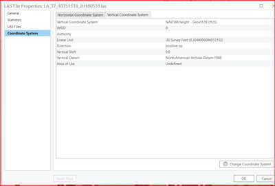

Hello,
Wondering if I can get some assistance with an issue I am experiencing with a task in the 3D basemaps solution.  I'm trying to run the 'extract tree points using cluster analysis' task and am having a coordinate system issue for my LASD. Here's a picture of the error:

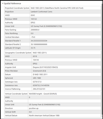

And here's a picture of the spatial reference information of the lasd (the individual tiles are all the same):
To me, it looks like all the units are in feet for the Projected CS, the Geographic CS, and the vertical CS. There's something big I'm missing and would be so grateful if someone could teach me what I need to know. Is there something that doesn't jive between NAVD88 and NAD83? Where should I be looking to see that the 'vertical and linear units' aren't the same? Any guidance is very much appreciated.

Allison_Hockey
Hi @Gert_van_Maren
thanks for responding to my inquiry. The script is throwing an error on the first las file it grabs. All of the las files have the same CS. I tried removing that specific file from the lasd and it does the same thing. I used the extract las tool and removed the vertical CS from the lasd and it threw a different error (no features were found, I believe.)
Here is the CS information on that specific las file:
This could certainly be an issue of the user not knowing what she doesn't know and if so, I'd like to learn!
To get around this, and in the interest of time, I created the trees running  surface analysis and didn't have this issue. I would certainly prefer to do it with cluster analysis if possible. Looking forward to some resolution 🙂
Thanks again

Hi Allison,
Couple of things:
- I removed the VCS using the 'Extract LAS GP tool and this gets around the first error
- when running cluster analysis, you need to make sure the 'Use return numer 1' toggle is on. The las only has return value of 1.
Then the tool runs but because the lidar is so dense, it will take a long time to finish. Better to run the Vegetation from surface task or run it on a smaller dataset.
Gert
