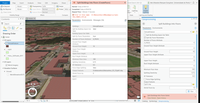

MateusMagarotto
Dear Gertvan Maren
I tried both ways  with the following parameters:
Can you help me?
Best regards
