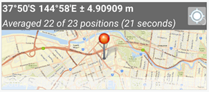

Averaging enabled on geopoint questions
Capturing a location with a single position is all well and good, but we wanted to do better. Geopoint questions now have support for averaging a series of positions into one single location.

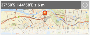

To capture your current location, tap the location button in top right hand corner of the location panel.
To start capturing a location built from an average of positions, tap and hold the location button in top right hand corner of location panel. You will see the message appear ‘Averaged 1 of 1 positions (1 second)’.
To stop averaging, tap the location button again. To delete this location and start capturing a new one, tap the location button a third time.
If you press the form completion button whilst averaging is happening, you will cancel the current location calculation and the previous location collected will be used.

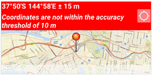

Positional accuracy threshold
Using the new body::accuracyThreshold column title in your XLS file, you can help field users capture more accurate data. The value in this column is expressed in meters. If the device used to capture a position is reporting a positional accuracy that is less than the threshold, then the user will see the geopoint panel be shown in red and include a warning message. Once the positional accuracy is better than the threshold, the title area will go back to normal. Note that the warning does not prohibit you from capturing a location.
If averaging positions as described above, any position beyond the threshold will not be used in the location calculation.

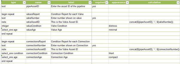

Better Repeats
Questions inside a repeat can now contain constraints, calculations and required fields.
In the following form, multiple values and connections on a pipeline can be surveyed. The ID of each fitting is calculated to incorporate the pipe ID, and many fields are required.
This should not be news to you, but using multiple repeats within a survey is supported as long as you do not nest them. That is, as long as you do not include a repeat, within another repeat.
Default values are not yet supported within repeats, but will come in a future release.
