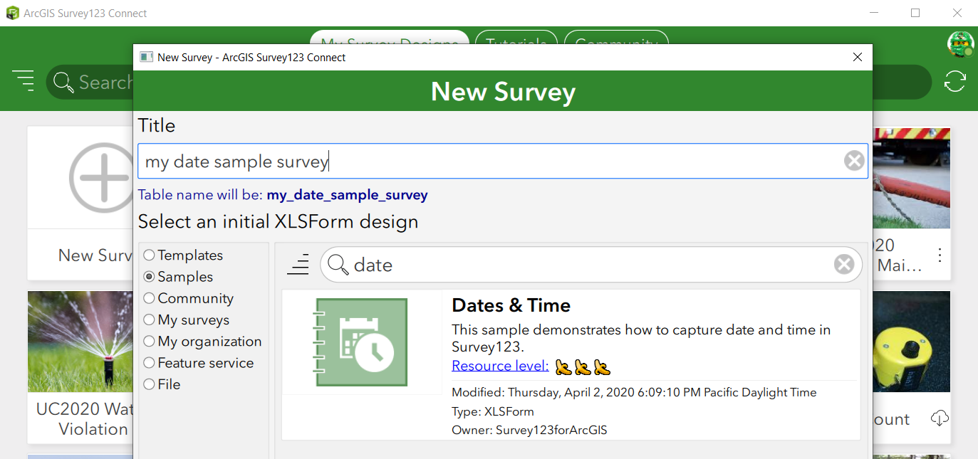

To best follow instructions and concepts in this blog, I suggest you open the Dates & Time survey sample in Survey123 Connect. If you have a first look at this sample survey, it will much easier for you to follow content in the blog.
- Open Survey123 Connect
- Tap on New Survey
- Select the Samples category
- Scroll until you see the Dates & Time survey sample or use the search function.
- Create a new survey from this sample
Next, spend some time going over the survey. I suggest you explore it first in Connect and you also bring it into your phone or a web browser to see what it feels like. The structure of the blog pretty much follows the sample survey.

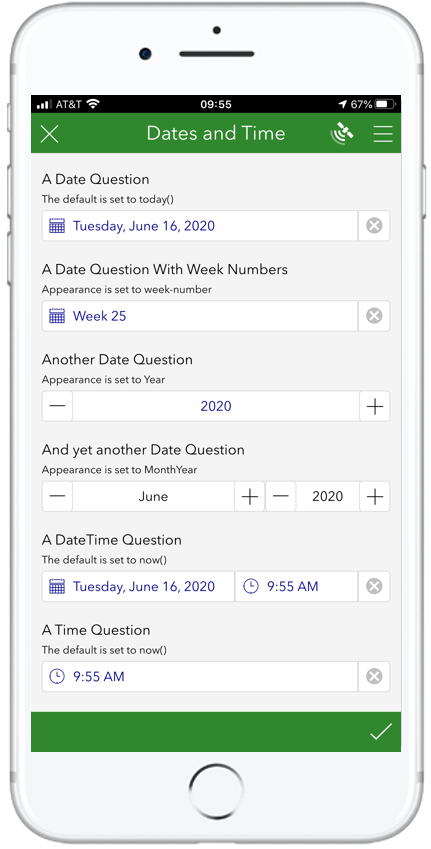

The first question in this survey is of type date and it uses no appearance. A calendar control is shown for users to pick a date. Note that the question shows the current date by default. This is accomplished by setting the default column in the XLSForm to today().
The following 3 questions illustrate the use of appearances: Year, Month-Year and Week-Number.
- Week-Number is the most exotic. Week numbers are often used in government and business for fiscal years and timekeeping. With this appearance, the calendar widgets will let the user pick a date and display the week number in the form. You will also see the week numbers on the side as you select the date. The week numbers are calculated following the ISO-8601 standard.
- The Year and Year-Month appearances are handy when you simply want to present the user with a choice to pick a year, or a year-month.

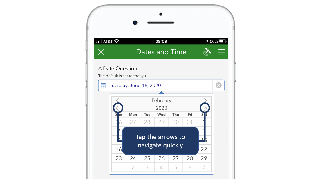

As you exercise the calendar control, it may not be obvious, but you can actually tap and hold the arrows to quickly navigate back and forth in time.
- The DateTime and Time questions are shown at the end of this first section. Note that the questions automatically show the current date and time. This is accomplished by adding he now() function into the default column.

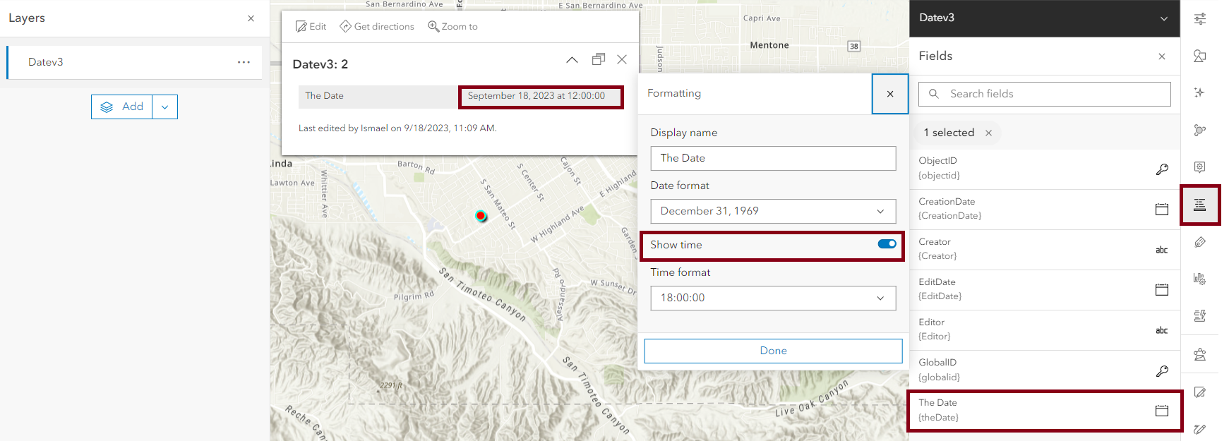

User input to the Date and DateTime questions will be persisted in ArcGIS in a field of type Date (esriFieldTypeDate). Despite the name of this field type, ArcGIS does not store just dates in Date fields: ArcGIS date values always include time as well. Hence, there is a perfect match between DateTime questions in Survey123 and ArcGIS date fields, but when it comes to date questions in Survey123, you need to understand that actually the time will also be stored. But what time? Well, it depends:
- The time will be noon (12:00PM) if the user has manually selected a date, or if you set the date using the today() function.
- The time will vary if you set the date using the now() function. Now captures the current time, even if your date question does not show the time to the user in the form.
The screenshot below shows how you can configure a date field in your layer to display time. Note that in the Map Viewer, I had to open first the Fields dialog, then click on the date field and finally turn on the "Show time" option. Once you do this, your popups will display time information!
Time values in Date and DateTime questions are always persisted as Coordinated Universal Time (UTC). This is important when you have people working in different time zones. ArcGIS clients will translate the stored UTC values into your local time zone. The only exception is ArcGIS Pro. ArcGIS Pro will show the time in UTC (unless configured to do otherwise).

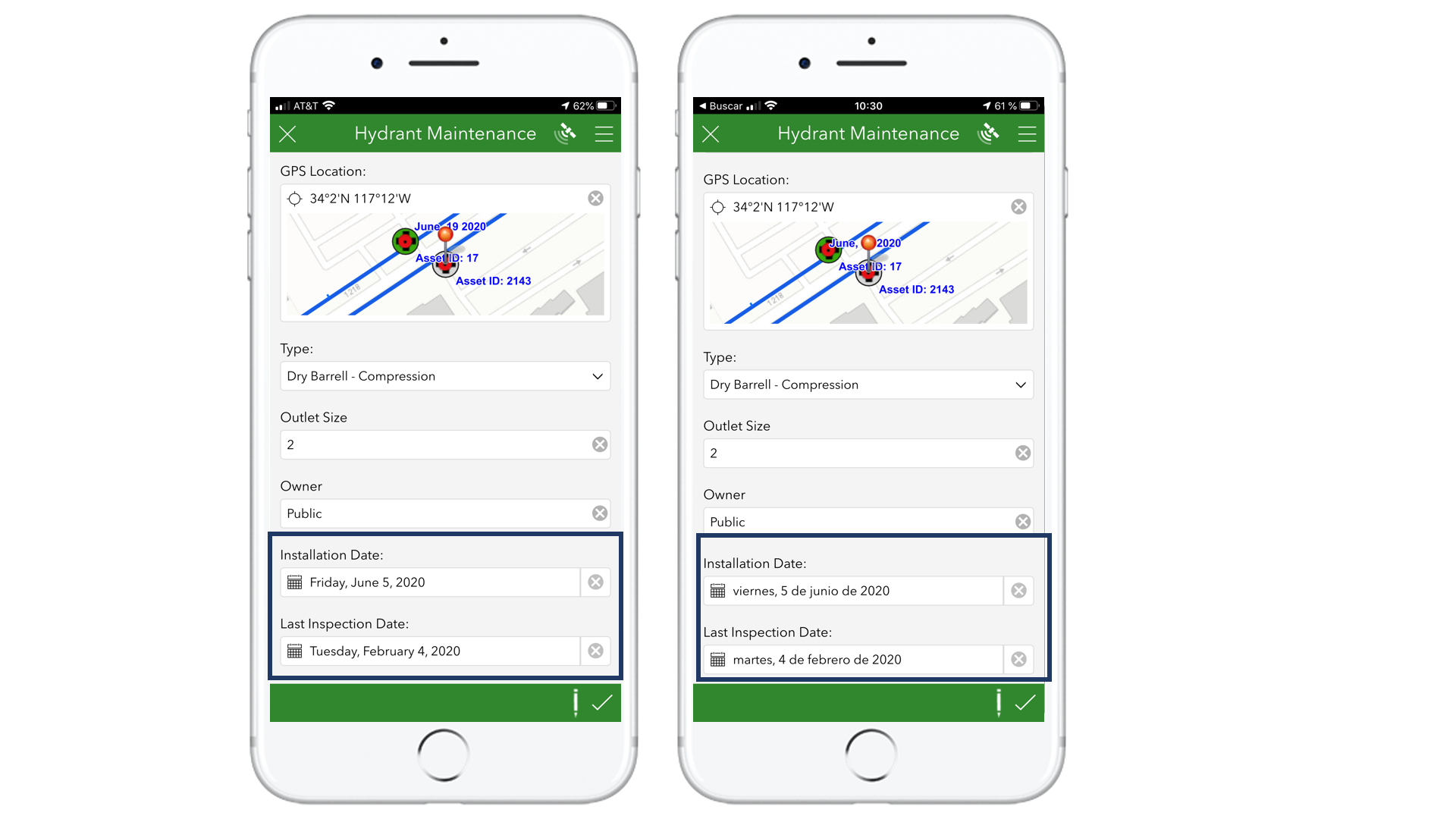

All graphical controls in the Survey123 apps will honor your locale regional settings. For example, if your browser or smartphone's locale is set to Spanish, then dates will be formatted the Spanish way (which is the correct one, by the way... just kidding). In the next screenshot I show what the calendar control will look like in a phone set with United States vs Spain regional settings. Note that when using the Spain regional settings, the day goes first, then the month and then the year, versus the US version where the month goes first then the day and then the year.

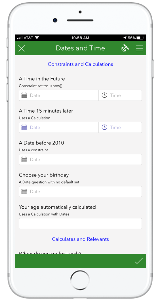

This section of the sample survey will be useful to understand how you use formulas with dates and date-times, so you can validate user input, as well as pre-compute date values. The questions in the survey are self-explanatory, The best is that you have a look at the XLSFile to better understand how things are done.
Constraints: A common constraint you will want to enforce is one that ensures a date is in the past or the future. That is pretty straight-forward: .> now() will ensure the user input is in the future for example. If you want to reference another question in the survey, you can use something like this: ${birthdate}<today(). This will ensure that the birthday question has a value in the past.
In constraints you may be asked to ensure a value is always newer and older than a fixed date. The date function is very useful in these cases. For example, you can set a constraint such as . > date('2006-01-01') or ${manufacture_date} > date('2006-01-01').
If you need to work with time constraints, simply add the time component to the date() function using the ISO 8601 notation.
- Calculations: Calculations are easy too, as long as you understand that dates in the Survey123 app are encoded as numbers. When users pick a date or a date-time in the survey, all values will be presented in a human friendly way, but internally the application handles them as numbers that represent the total time elapsed since 1970. A positive number represents a date after 1970 and a negative number a date in the past. As you can imagine those are pretty big numbers, but the math is simple once you understand how time is expressed. There are basically two formats for the elapsed time:

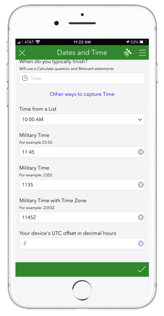

- The 'Time from a list' example should not come as a surprise. A select_one type of question with minimal appearance is a nice way to present a list of hours to choose from.
- Then there are some other examples illustrating how to use regular expressions in constraints as well as input masks. I will go into the details here, so nothing is missed.
- First, an example to capture military type with a period. For example: 11:35. Note the use of an input mask here. The input mask automatically adds the period (:), so the user does not have to worry about that. The value of the input mask is 99:99 meaning that we expect to digits followed by a period and two more digits. You will see that the constraint column checks to make sure that the hours do not go beyond 23 and the minutes do not go beyond 59. Note: input masks are NOT supported in the Survey123 web app.
- In the second example, we want to capture military time, but without the period. For example: 1135. In this case, I want to highlight a couple of things. First, note that I am not using an input mask like before. It is not needed, because we can set the type of question as integer (to ensure that only numbers can be typed) and also set the the maximum length of the field to 4. This is done through the bind::esri:fieldLength column. This will do two things: will ensure that only integers with 4 digits can be entered into the Feature Service, and most importantly, will limit the user input in the Survey, to 4 numbers. I still added a regular expression in the constraint to ensure that proper values within the 24 hour day are entered.
- In the third example, I want to capture military time including the time zone. For example 1445Z. Z is the time zone (ZULU, which represents UTC). In 1445G, G is for Golf and represents UTC + 7. That would be 1445 Golf Time. How awesome is that! More details on this crazy business with Time Zone Abbreviations here. Again in this case I added a mask and complemented it with a regular expression in the Constraint.
