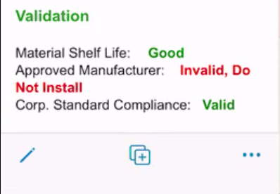

Screenshot of portion of Collector pop-up
Collector will automatically decode the barcode information and open a pop-up window with the validation results. Invalid pipe segments, devices and fittings never reach the installation trench.

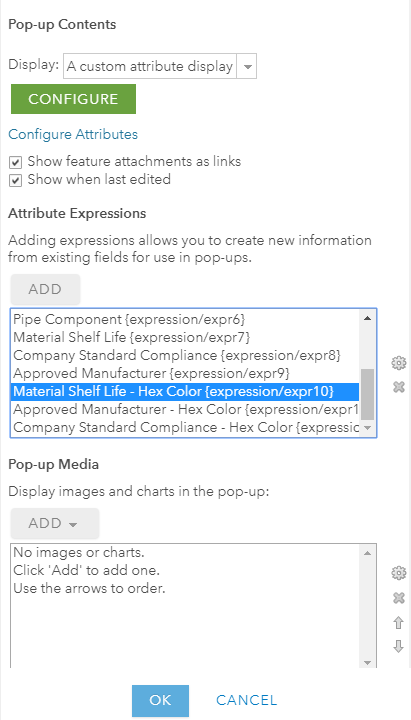

Esri makes real-time validation possible by allowing arcade scripts to be added to the web map configuration file. More specifically the arcade script is added to the pop-up configuration in the web map of the pipe, device or fitting layer.
Screenshot of portion of pop-up layer configuration

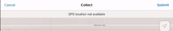

With the arcade script added to the desired layer pop-ups, the web map is now ready for real-time validation. For the field user, initiation of the validation process occurs automatically when the field user presses the “Submit” button in the upper right corner of the Collector display.
Screenshot of top portion of Collector application
The pressing of the “Submit” button after collecting some information such as scanning of a barcode also automatically opens the pop-up to show the validation results. It really is that easy to deploy and that seamless an experience for the field user.

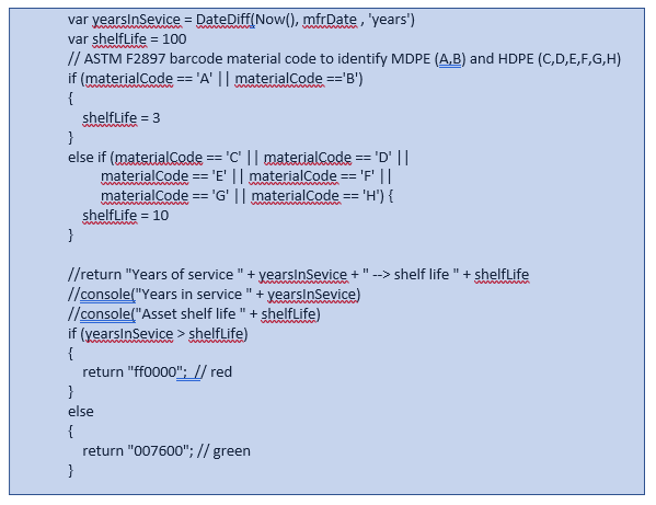

The simple answer is that it must be able to acquire the information needed to answer a question. For example, a core validation for plastic pipe construction is whether the polyethylene plastic material is too old. Polyethylene plastic is susceptible to the suns UV rays. Let a roll of medium density polyethylene pipe site in the service yard for over 3 years and the sun’s UV rays will have degraded the material to the point where it should not be installed. The information needed to assess whether the role of pipe is too old is the date of manufacture and the current date. The date of manufacture is acquired form the scanning and decoding of the ASTM F2897 barcode. The current date is acquired from the mobile device itself. Subtract the manufacture date from the current date and you have a time difference. If the time difference exceeds the industry recommended shelf life then that roll of pipe is invalid and should not be installed.
Here is a snippet of the arcade script to determine whether the polyethylene plastic pipe or component has exceeded the recommended shelf life.
Portion of arcade script to determine material shelf life
