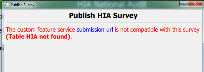

Having some difficulty adding values to the "choice" list of our survey123 form. Note originally published in July 2015, and has been running fine since 🙂
After editing the XLS Form (Survey123 Connect 1.10.43) and attempting to republish returns a URL_Submission issue/error >

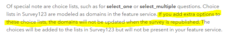

Wondering if this could be the cause: (Ref here > Publish your survey—Survey123 for ArcGIS | ArcGIS )
Please advise of suitable workflow that does not affect the existing feature service, ie we want the update to be seamless to users (apart from downloading new form) to their device. Note no schema changes just adding an additional choice/domain!
