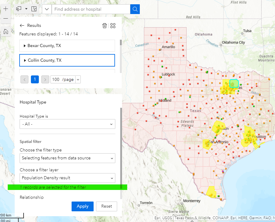

Currently, Experience Builder’s query widget requires physical interaction to select results and pass them to another widget. The query results list also only allows for a single feature to be clicked and selected for use in another widget, such as a spatial filter for a second query widget. Attempting to select another feature deselects the one previously chosen. The screenshot below shows an example similar to one I am currently working on:
Only being able to select one feature from the results seems to defeat the purpose of being able to select the output of a query widget as a spatial filter input of another query widget. The software enhancement request we submitted proposes functionality to select all the results in a query widget, not just a single one. Automatically applying the results of the first query widget to the spatial filter of the second would be perfect, but an option to select them all in the Actions menu of the first widget would work as well.
